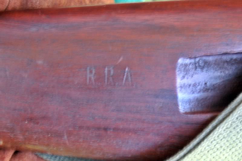

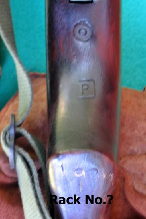

    I can't give you an answer as to why the P is in a square instead of a circle but my Underwood M1icon Carbine has the same mark:

    Would it make sense that my carbine has the San Antonio proof mark and the Red River Army Arsenal rebuild mark?

    Your carbine has a Red River Arsenal proof mark. Red River Arsenal also used the P in a square proof mark.
