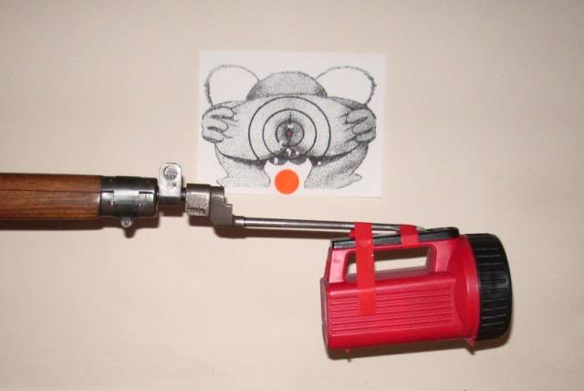

    Or I can let you borrow my Paul Hogan magnum bore light.

    Ed is that spike a singer Mk1. The lantern is a good idea but the barrel harmonics will be out of wack so the group shot probably wont hit the barn let alone the koala. Suggest you fix it under the barrel, better still tape a laser under the barrel then your old eyes wont have to strain just point and fire.
