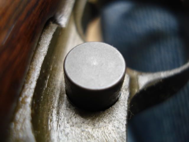

    Hi Guys,
    Does this seem authentic to you? I'd like to buy it if it seems okay.
    Thanks,
    Josh

    I'm guessing it is a fake, but just thought I'd ask for other opinions...
    Thanks,
    Josh

    Josh,
    If you can take some macro closeup shots of the "EW" marking and opposite end, it would help.
    BTW I will email photos full size tonight on the flip sight.
    Based on current photos, I'm not seeing what I'm looking for and would say fake.

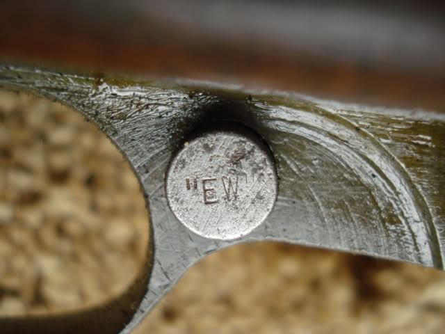

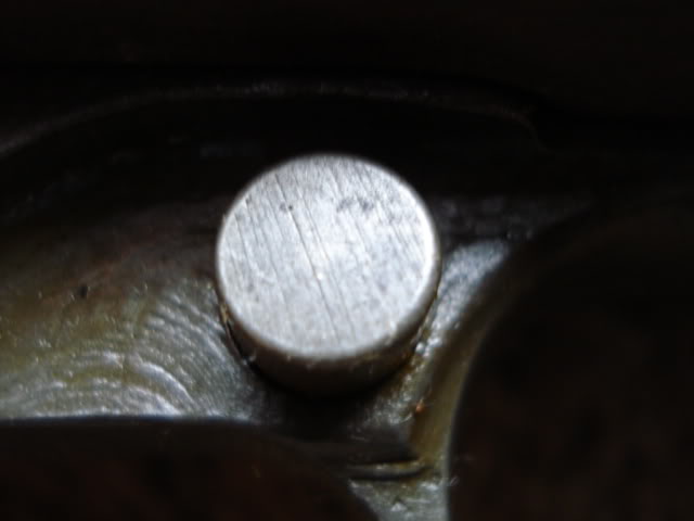

    Hi folks,
    Thanks a lot. Here are some more photos:
    I'd say fake, too, but the "EW" looks the same to my eyes as the one above. Only the finish looks suspicious.
    Josh

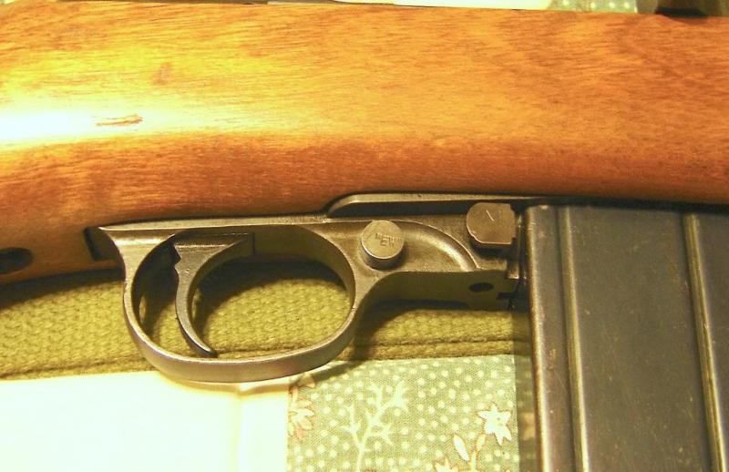

    Josh,
    By chalking the markings, they make the letters look wider.
    I think what the guys are looking for are any signs of 1940's style mill working. From what I can see.....the letters and placement of the ( " ) markings seem to look legit.
    The "EW" marking is harder to look over when pictured from the side or angle.
    The finish color is hard to make out from picture, it always is.
    Your safety shows little use. The finish also appears to be dark, darker than most USGI finishes and compared to known EW safeties.
    It's very possible it was re-finished while in the hands of another country, the lend lease, or by a importer before being sold.
    I'm including some pictures here of 2 different "EW" marked safeties. I've seen what appears to be three types of markings on these over the years. All found on original "EW" safeties.
    The impression left by a newer stamp vs an older one surely varied. They didn't use just 1 "EW" stamp to mark all those safeties. Was the part always stamped with the same amount of force?
    I can't say.
    One version looks as though the W is wider at the top.
    Another shows the middle leg of the E extending farther to the right.
    The 3rd, like JimF's....has the letters closer at the top. Note on his picture that the top leg of the E nearly touches the top left leg of the W.
    I've seen them with fairly heavy milling scars and others barely showing signs of milling. The final prep before applying a finish could answer that. Winchester IMHO had some lack luster milling styles.... some almost to the point of being sloppy. Not in fit, but the milling varied greatly. Maybe operator fault.....or production style.

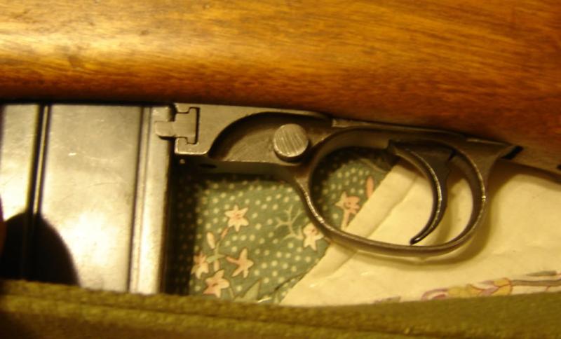

    This first one is on the 5,573,xxx that my Father brought home from the Philippines. It is a original carbine. The letters have grease in them. I just wiped it clean enough to get a decent picture. The W is the type that looks to be narrower at the top.....
    This one is on a 5,811,xxx. The W is the type that looks finer and wider at the top....

    "EW"
    The EW I had kicking around that I just put on my Underwood is fairly light compared to the one in question. There is a noticeable difference between mine and the questioned one, though, that I won't say on the list. Mine looks like Painter's
