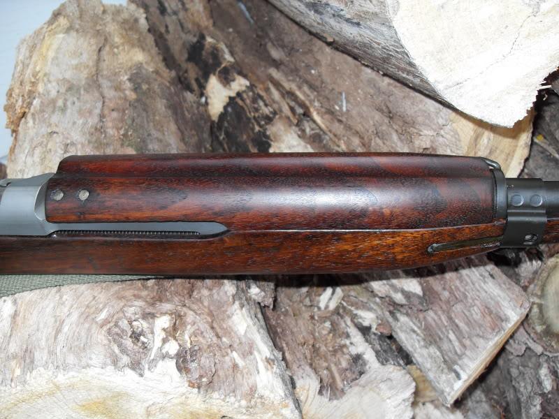

    I use both.. I typically put 6-8 coats of BLOicon on the stock, rubbing it in, rubbing off excess, and letting dry for a couple days.. Giving it a quick rub with 0000 steel wool before the next application.
    When I finally get the finish to where I want it, I go with Tung Oil Finish for 2-3 coats, also rubbing with 0000 steel wool..
    I like the depth of color and the grain that BLOicon brings out, but like the protection of the Tung Oil.. Since there's no problem coating over BLO, it's the best of both worlds!!
    Here's a recent Carbine I did..
