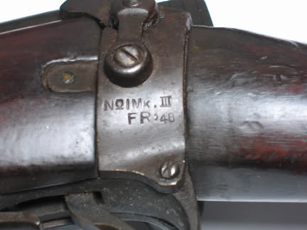

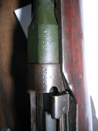

    I have a N01 Mk III Ishapore that I am stumped regarding the date of manufacture. The S# is 130xx Z. No letter before the #. It has an FR 40 mark.
    The barrel is numbered to the receiver.
    There is no RFI or date on the bolt side of the receiver.
    It has the cut-off slot.
    Any thoughts on when she might have been made?

    The FR 48 indicates it was completely rebuilt in 1948 - whatever marking that would identify it before that were removed. Does the barrel have a date on the left side of the knox form?

    1948 rebuild of - probably - an English 1914-16 rifle. Show us the right butt socket markings, and anything on the left side of the barrel.

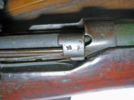

    I'll look at the barrel again but I don't recall a barrel date. There are absolutely no markings on the butt socket on the bolt handle side ... none. Doesn't even look 'scrubbed', although it must have been.
    There are GRI marks on receiver and barrel.

    Still no extra pics but, definitely no date and the butt socket, on the bolt side shows no signs of scrubbing. Absolutely smooth. Usually you can see evidence of the scrub.
    What does the serial number tell us? 'Z' after the 5 digit number. Did I read somewhere that Ishapore started the letters backwards on one of their FR series? In the 1960's maybe?

    You are dead right about the serial number prefixes running backwards for these second type FR rifles----I have an "FR '49" rifle with an "X" prefix.
    The smooth right side of the buttsocket is normal for these rifles----but do I spy a Britishicon "GR" proof on the receiver ring just below the Indian "GRI" proof?
    If so, that's more origin information than I've ever seen left on an FR.
