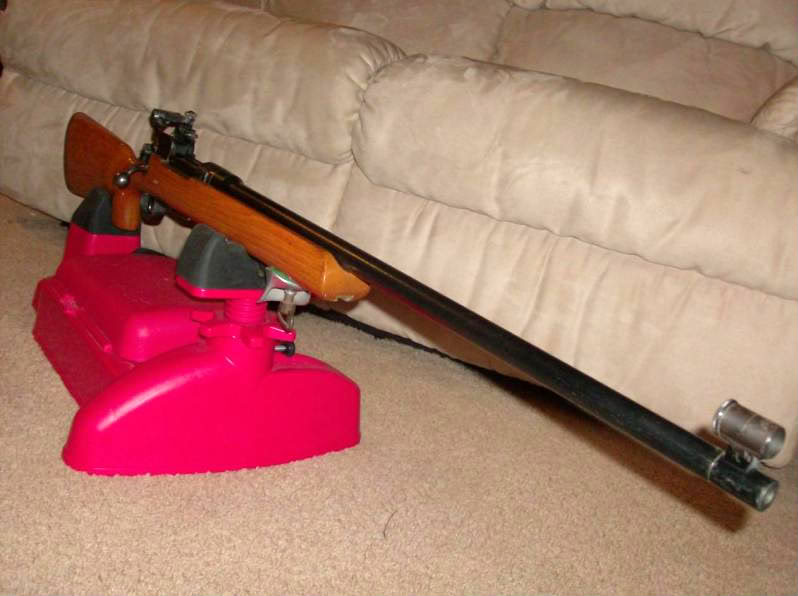

    Thanks guys. Here's the M1917 with its PH installed (it has a neat stock):

    If it has a good bedding job, bore, trigger, and speed lock (in decreasing order of importance-roughly) then it ought to be a fine range rifle. A bit old school, but that's the appeal, unless you are really wanting to play w/ the big dogs.
    ETA Its interesting in that the rear sight protecting ears are still intact. That's usually one of the first things to go!
    ETA some more: If that was a new design, that would make a great place to put one of those Doctor Optic sort of things. Add a ballistic compensator computer thinggy for the long shots....

    Yeah, I guess you could very appropriately say I'm pretty old school!
    Thanks JM,
    Lou

    Hammer-forged L39/L42/Enforcer/Envoy barrel on an M17. Should be quite a combo!
    Lots of people would like your 7.62mm TZ for their DCRA conversions so you should have no trouble trading it for a minty .303 model.
    Or of course you might like to keep it for your own .308 No4...
    The no-drill AJP sight for the P14/M17 is out there as well. Of course if it's already drilled then 'do what you feel'.
