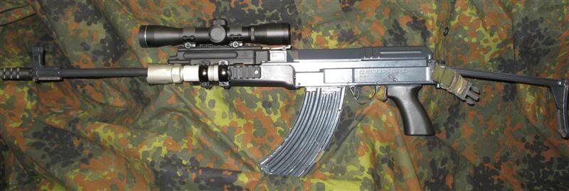

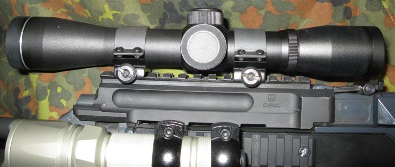

    I haven't had any RTZ issues with either of my NEA rails, both 3rd and 4th Gen versions.
    Here's something different, I haven't had a chance to try it out yet.

    Is that a scout scope? I was thinking about using an Eotech 552 on my CZ and backing it with a G 23 or Aimpoint 3x magifier for hunting but: 1. not enough room on the rail and 2. not enough eye relief.

    It's a 4x, illuminated reticle, LER scope. IMO an Eotech is too tall for the VZ.
    I don't hunt. It's just for playing at the range and in the bush.

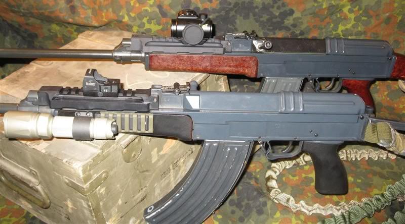

    Quote Originally Posted by dastier View Post
    Haven't tried the 552 yet as I'm waiting on the hand guards but I believe it may not co witness with the front sight.
    It absolutely will not co-witness on any mount you can put on a VZ.
    You can co-witness with an Aimpoint Micro-sized/shaped optic or other round-type optics in rings that bring them right down close to the rail.
    The Bushnell TRS-25 on the top rifle has about a bottom third co-witness. You can't see the irons on the lower Burris FastFire equipped rifle unless they're raised to about the 500m setting. Both optics are a lot lower than an Eotech which is designed to mount directly to a flat-top AR and give an absolute co-witness.
