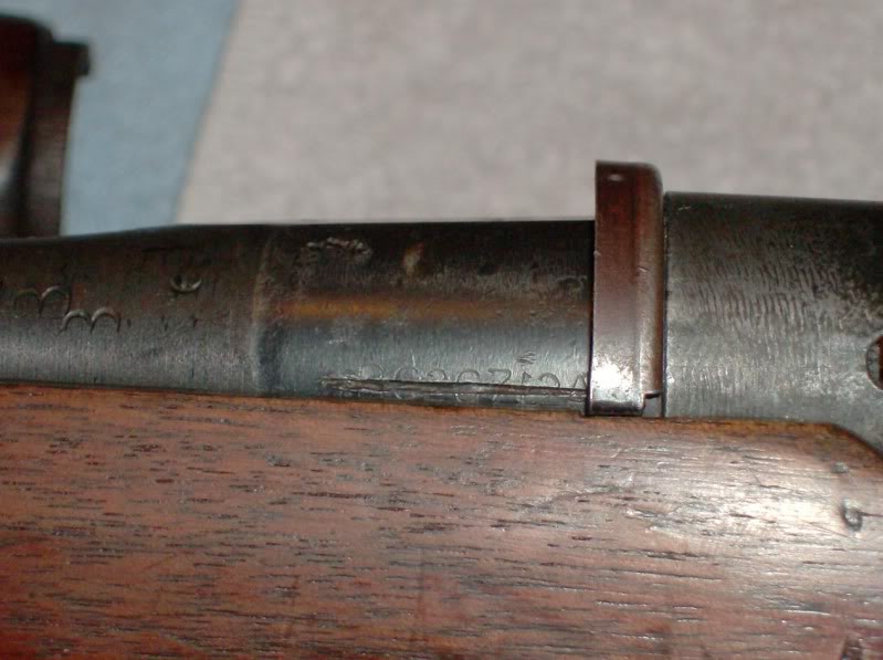

    Here are a few pictures I took of a friend's No4Mk1. Since I know little about the true T's, I thought I better enquire here and get some factual info.
    It has what I believe is a correct scope mount, but not the scope. The scope rings are numbered too.
    Butt socket:
    Scope mount side:
    Top of knox: (I think that's a circled "D")
    Crossed number on barrel:
    Any info anyone has about this would be greatly appreciated. I suppose the goal here is to get a ballpark market value in Canadaicon, and look at the likeliness of finding a scope for it?

    Well just as a starting point the bracket is a reproduction. The “TR” stamp on the butt socket doesn’t look correct ether. It looks as though it is struck as a single stamp. Of the ones I’ve seen they are usually struck as single letters, larger font size and lower on the socket. My knowledge is much more limited on the early conversions and like so many I’m learning more with every post here. The barrel is plainly a replacement.
    I’d like to see photos of:
    The back and front mounting pad with the scope removed.
    Inside the receiver where the screws for the front pad go through the receiver.
    The area at the back of the receiver ether side of the bolt race way below the back sight.
    Is there a scope number on the top front of the butt just before the socket? Does the rifle serial number repet any place else on the rifle?

    I've never seen one with the TR as a one-hit stamp. The TR is either missing or on most of them, like it's been hit by a blind man on a dark night. They're all over the place.
    Not indicative of anything but it's unusual (?) to see a BSA No4 with an 'A' nothing-is-going-to-fit serial number suffix. I just assumed that this was a distinctive wartime Fazakerley identifying feature. Even the figure 1 has been hit upside down

    Is that a partial 4 on the year on the butt socket? Or an upsidedown 7?

    It looks like an...., er..... well, it could be anything! No, seriously, it looks like a mis-hit figure 2 as in 1942.
    When these used to come across our benches, we weren't allowed to do anything but barr-out the old number and as there was no room to barr-out and start again, it meant that the number had to be re-engraved on the body side where we weren't allowed to use stamps. But that was a lot of effort so we'd just knock the old numbers down a bit, make good (as in obliterate.....) and then re-stamp...., properly! After all, it was going through the man-size bead blasting booth (it was big enough to take an MGB GT V8 front cross member with ease) and then through the phosphating tank and paint booth
    The problem arose when you had your OWN shot out heap of tat No4T in the workshop at the same time, for a bit of a tarting up (another REME technical term for a 'going-over....') and you got the numbers mixed up with a virtually brand new, rebarrelled, range tested, calibrated, rebuilt telescope etc etc No4T. You were then left with the choice of changing the numbers back again and keeping your own heap of tat or just letting things stand. Sadly, I chose to let things stand to avoid messing the books up and regretfully, I still have the replacement to this day..........

    What little that shows of the rear pad looks odd to me...
    Looks like there's fresh flux residue (rust) leaking from the front pad.
