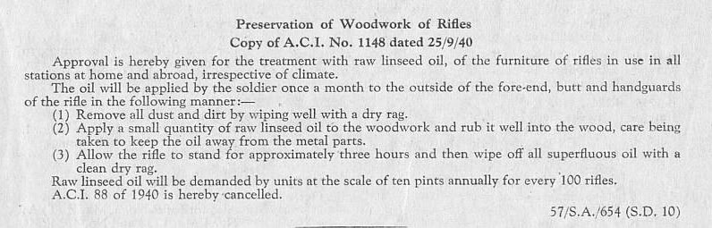

    RLO – raw linseed oilicon was applied during the war.
    A water or alcohol base stain works the best, an oil base stain will seal the wood and prevent the linseed oil from sinking deeply into the wood.
    Warning, todays BLOicon is fake and is toxic, read the MSDS sheets for the product you buy.
