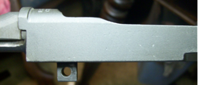

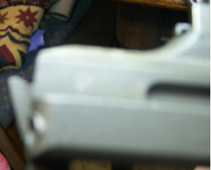

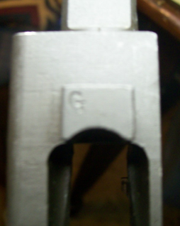

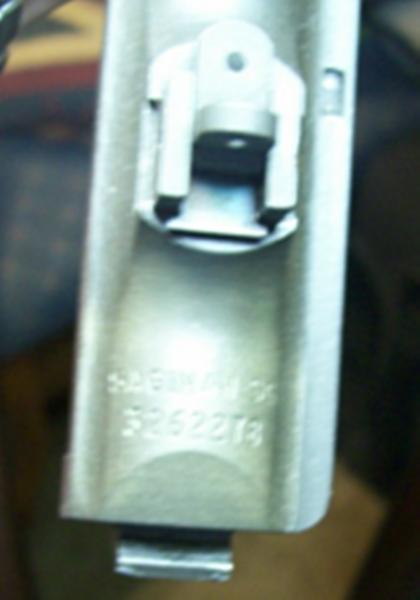

    Brian, Thanks for the input. I've gone back and reread and looked at the info. you were able to share. I will try to take some pics. and post them for the forum. I might fill out a data sheet and pass it along to John. Later, Bob.
  9. #9
    Legacy Member BrianQ's Avatar
    08-21-2022 @ 04:50 PM
    466
    06-11-2025
    12:32 AM
    Posting Pictures for Bob of his narrow tang SG carbine.
  10. #10
    Bob Loughlin's Avatar
    03-13-2014 @ 09:50 PM
    36
    11:32 PM
    I thank you Brian. Somehow your posting the pics. are clearer than the ones I shot. The last photo of the right rear of the receiver has a P stamped in it the same size as the P that S.G. used to stamp the proof on the barrel. Bob.
