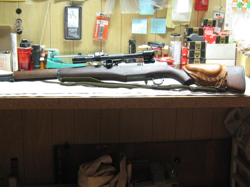

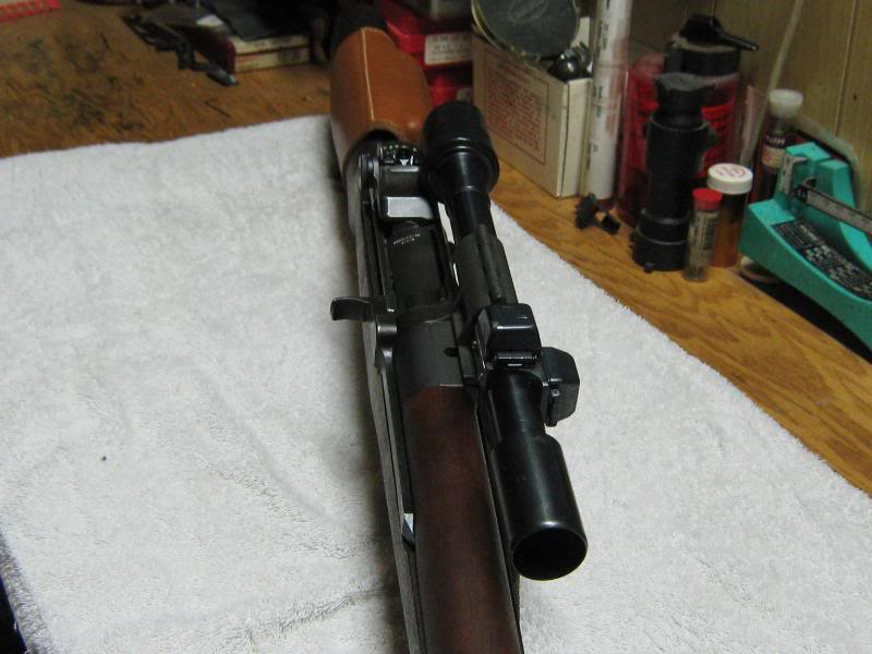

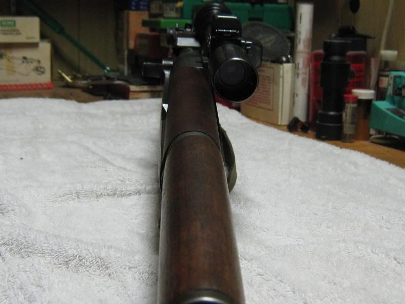

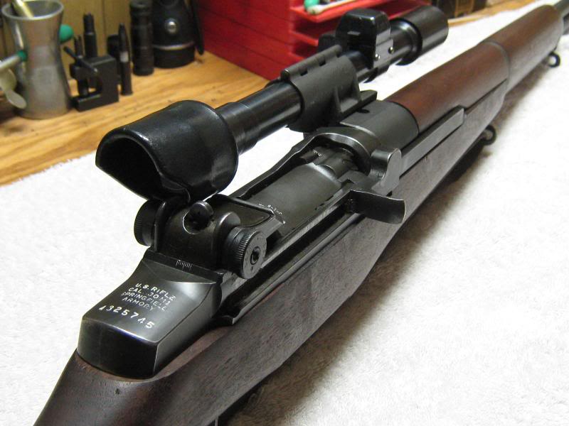

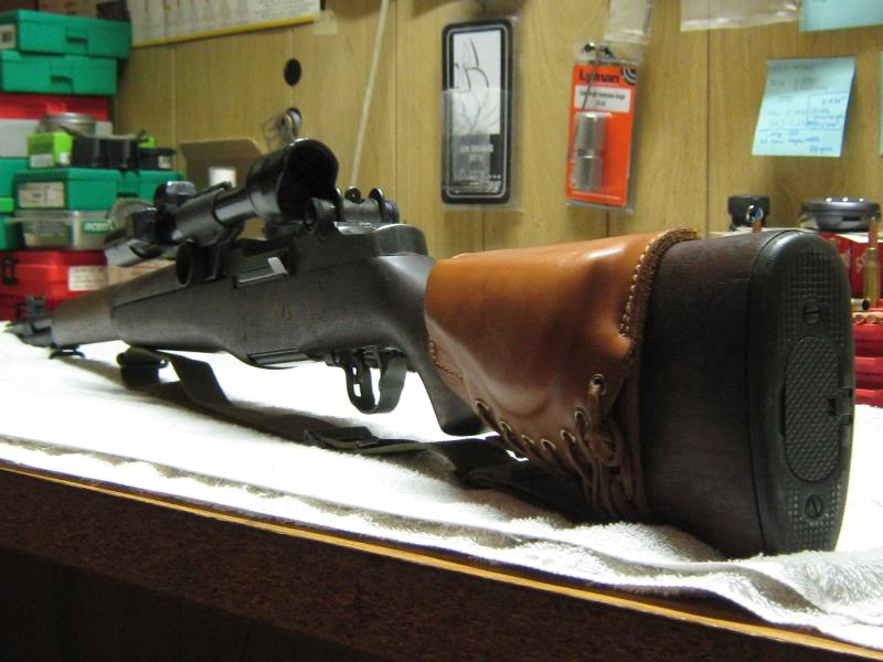

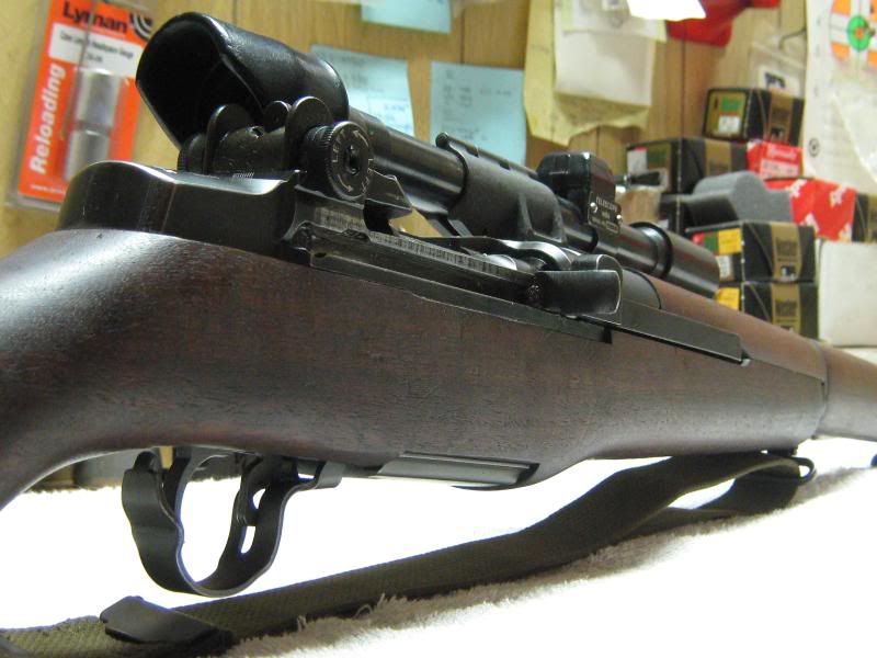

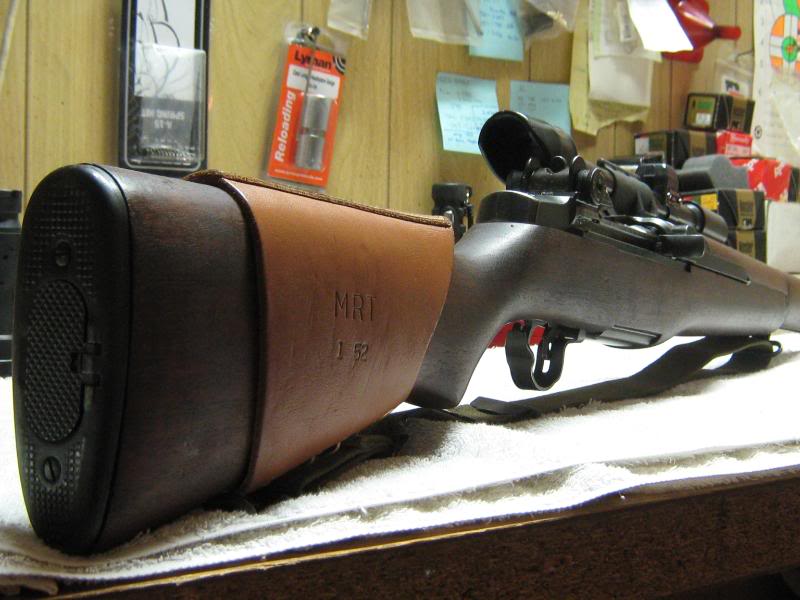

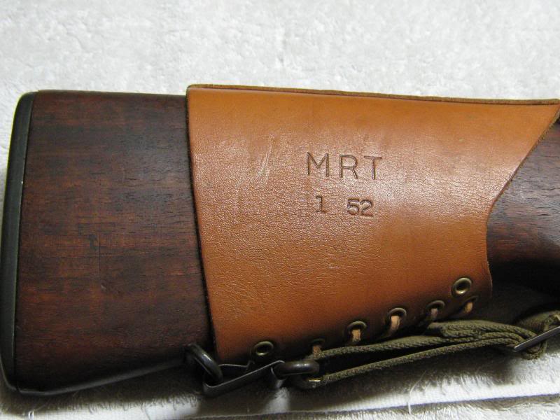

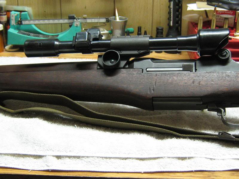

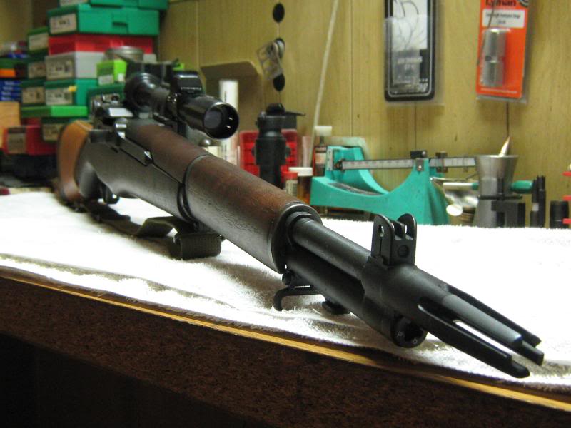

    My M1D (caution, long winded and many photos)
    Here is the M1D that I have, I aquired it in a trade. I didn't get any papers with it but all the pieces except the T37 are genuine. Here is the parts breakdown.

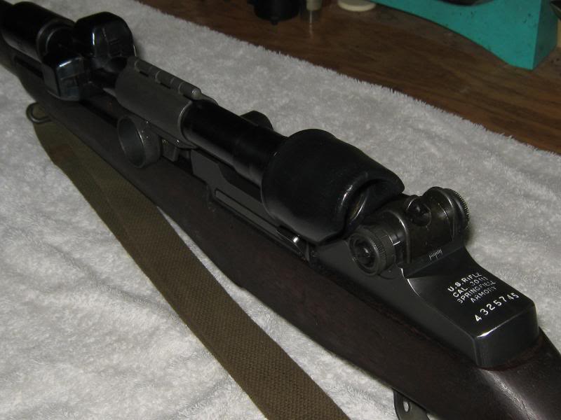

    Reciever markings:
    A46B
    D6528291 43

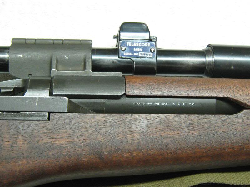

    Barrel side markings:
    D7312555 MD 34 SA 11 52
    Barrel top markings:
    Crossed Cannons, M, T
    M.E.-0
    T.E.-1.5
    Rear sight:
    T105E1
    Front sight:
    SA, narrow, no cap, with screw
    Trigger housing:
    Small pad, cloverleaf,
    Trigger guard:
    Stamped, bent hook
    Hammer:
    SA 5546008, marked on top
    Safety:
    SA 11
    Spring housing:
    Blued
    Guide:
    Parked
    Front handguard:
    Walnut, late ferrule, late spacer

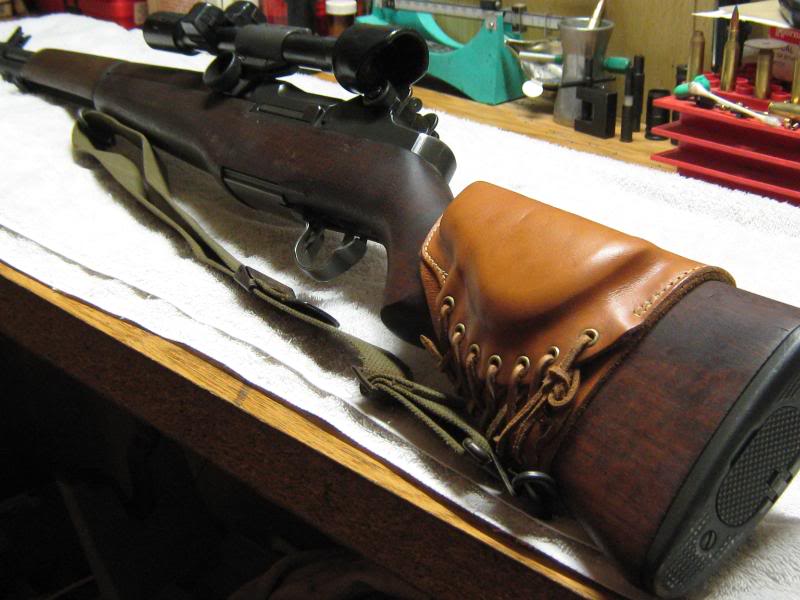

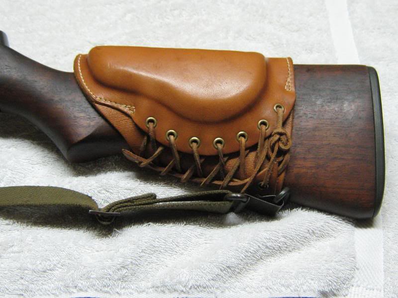

    Stock:
    Open boxed SA with RA, Circle P
    Bolt:
    6528287-SA J-I-B
    Gas cylinder:
    Un numbered, wide, late
    Lock:
    T37 (reproduction)
    Lock Screw:
    Marked P O(hexagon)correct for Win-13
    Follower slide:
    Late
    Bullet guide:
    Late
    Op rod catch:
    Late
    Follower arm:
    Late
    Lower band:
    Arched
    Clip latch:
    Late
    Op rod:
    6536382 SA
    Op rod spring:
    late

    Looks very Nice! Correct pad, scope, barrel, stock. I'd say it's authentic!

    That's a great looking rifle, and I'm going to use these photos as a reference for my upcoming purchase of an M1D.

    Very, very nice !!
