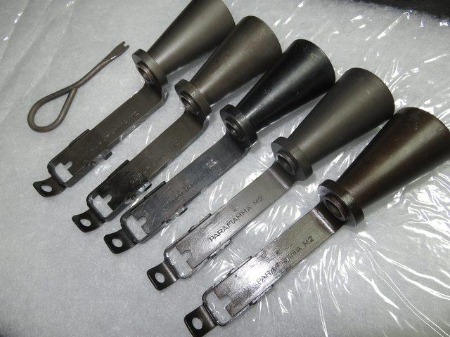

    Italian Cone flash hider
    Good Day,
    Here are a few examples of Italianicon military M2 cone flash hiders. They are similar to US manufactured examples and are marked "PARA FIAMMA M2"
    Best Always,
    Michael
