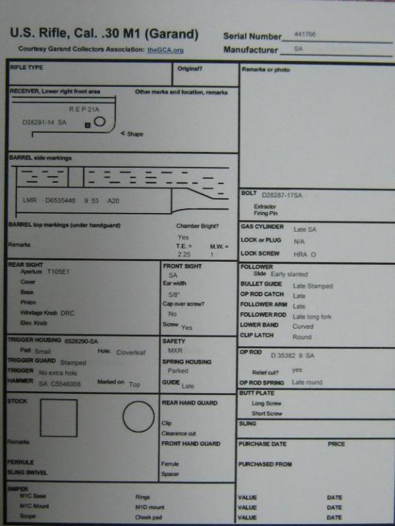

    I started cleaning the Garands for the local Legion Club today. They have ten rifles and I made it through five of them, they were dry and fithly. Out of the five I detail cleaned there was one H&R, two International Harvesters, and two SA's that were both in the 400,000 serial# range. After I disassembled them I made data sheets. Here is the two SA's. These rifles are as delivered to the Legion Post back in the 60's so I thought it would be interesting to see what parts they had ended up with when they were rebuilt, the Vets that were here when the rifles were delivered told me nothing had been swapped or changed. If I am filling out the sheets wrong let me know. Both rifles had unmarked birch stocks and walnut handguards, that's why I left the stock part blank.
