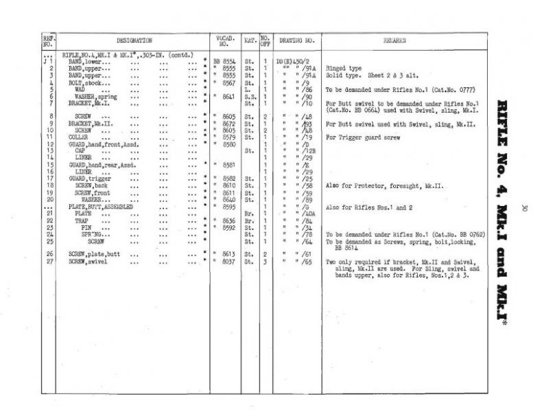

    Hi All,
    just a quick Q thats baffling me as I order parts; does the no1 mk3 front trigger guard screw come with a spring/lock washer, or even a flat washer? I find it every now and then on a rilfe, but schematics like Springfield Sporters don't list one.
    thanks

    Short answer is no not a military rifle part. Used as a short cut to fix a problem by ameteur gunsmiths.

    Extract of an old post by Peter Laidlericon :
    "............The COLLAR. You MUST have a collar and spring washer. This is what WE used to do. Put the front trigger guard screw into the trigger guard and body WITHOUT the washer or collar. Reverse it (that’s anti-clockwise …..) until you hear it click over the start thread and tighten it BUT COUNT THE TURNS UNTIL IT TIGHTENS AND LOCKS. Say, that it’s 7 ¼ turns to lock. Now do this with the collar fitted if it’s now, say 8 ½ turns, shorten the collar, a smidgin at a time, until the screw tightens up at exactly 7 ¼ turns. That way, you KNOW that the screw is tight, the fore-end is tight between the trigger guard and the screw and you are not crushing the living daylights out of the fore-end................"

    The No1 Mk111 does not have a spring washer but the No4 does show one S.A.I.S No.2 part No CR 387 / BB 8640.

    My experience with the No1/SMLE is quite limited to the odd ones that came through for FTR or the hundreds of EY rifles. If I remember, the washer would fit onto the No1 screw but the actual screw head was slightly tapered - as was the recess in the trigger guard. As such, the screw head locked into the taper. We'd always put washers in place just as good engineering practice

    Re Ed, parts lists showing the washer under the no 4 trigger guard, hmmm, I'm not so sure about that.
