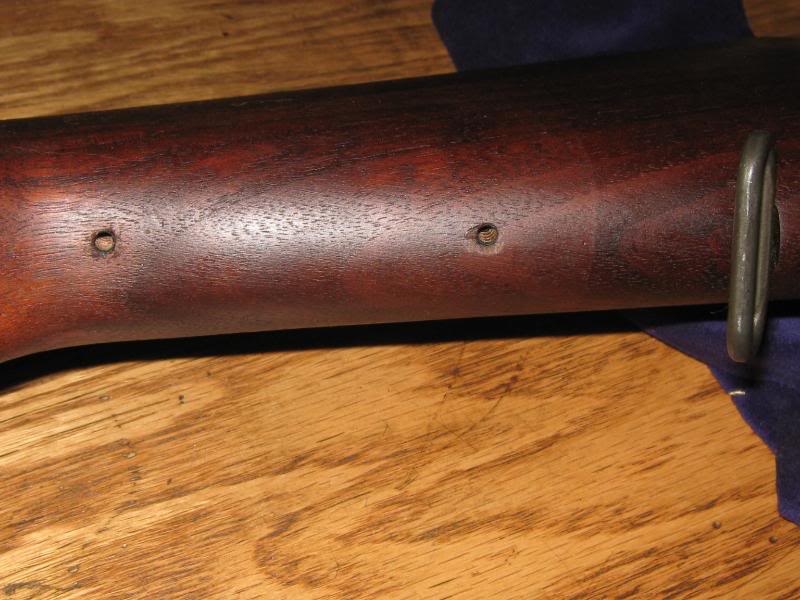

    The stock is the same with the exception of the markings. Most were marked like this, and there should be screw holes where the cheek pad was.
