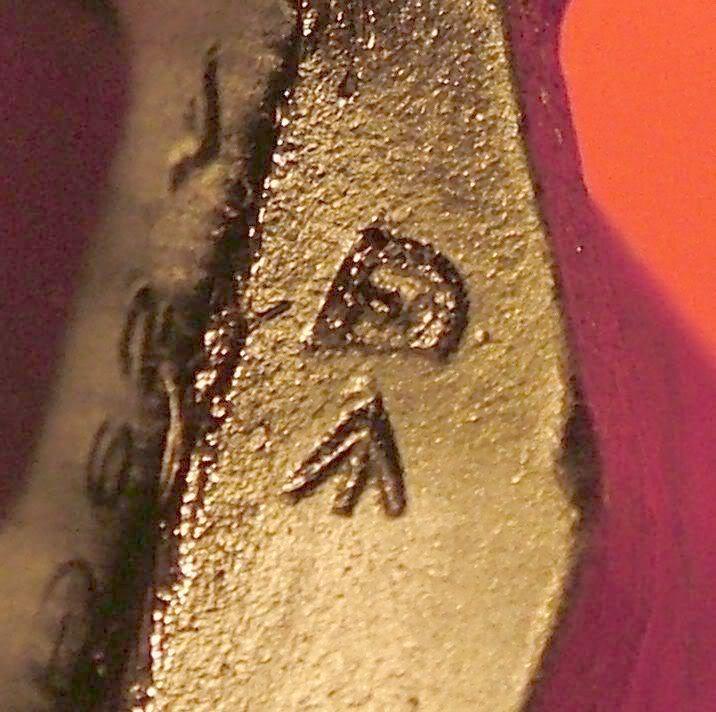

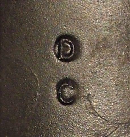

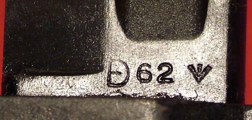

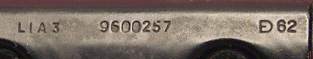

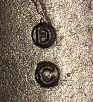

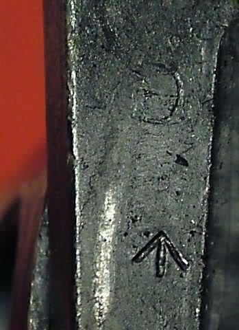

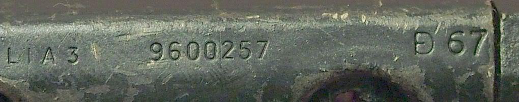

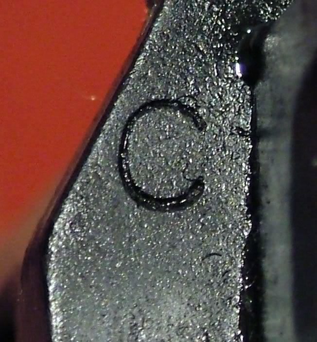

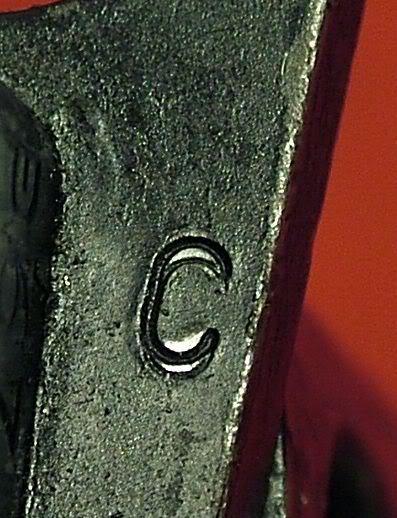

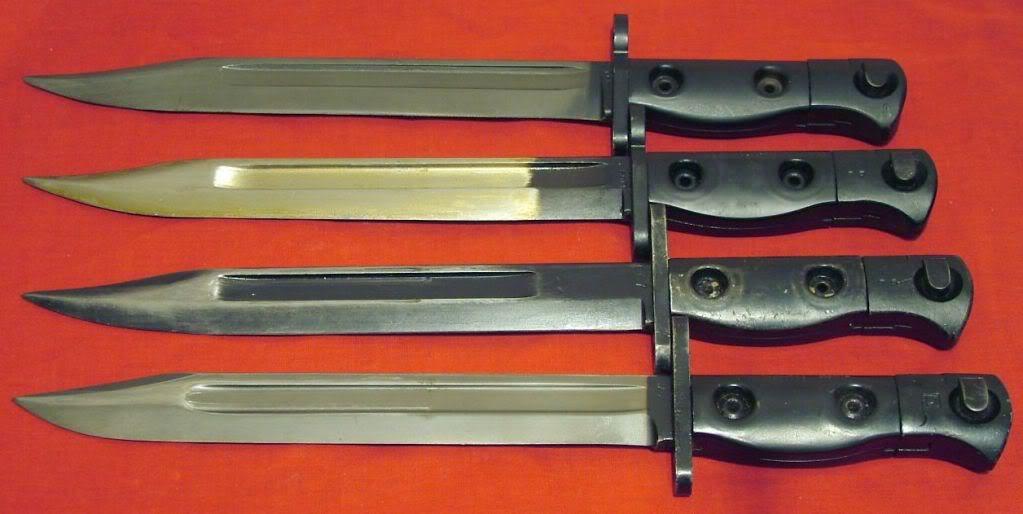

    This is the earliest L1A3 bayonet I have seen so far with Cast components on it. It has a Cast 'waisted' crosspiece. The bayonet is a 1962 Enfield.
    Crosspiece marking (Right side)
    Crosspiece marking (Left side)
    Grip marking
    Pommel marking
    Blade marking
    Grip marking
    Pommel marking
    Top to Bottom
    [b]L1A3 BSA 1961
    L1A3 Enfield 1962
    L1A3 Enfield 1967 (short fuller)
    L1A4 Hopkins? 1977 (<H> 77)
