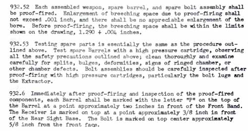

I don't think it was proofed from the shoulder.
You are correct. All proof firing was done in a separate area to prevent injury if something failed. The below pictures show proof firing of an assembled carbine (left) and a carbine bolt and barrel (right). The firing was done remotely.

I am not sure of the procedure shown on the history channel, but proof firing, which is high pressure test cartridges, was not done with multiple rounds, or by hand. I am sure the history channel got the procedures mixed up. One proof round was all that was used, as a firearm could not consistently adhere to the high pressure.
There were devices to test fire with permanent holding due to lack of impact area, like an underground dirt tunnel.
If you notice the text states "safety precautions".
I know of no records of how many firearms failed, but I can tell you talking to an employee at Springfield Armory, it did happen (Garand, M14
and 30 BMG) when they were handling thousands of barrels, bolts and firearms.
Don't know if they kept track of the overall percentage, I doubt it.
