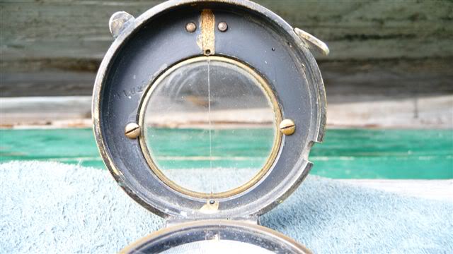

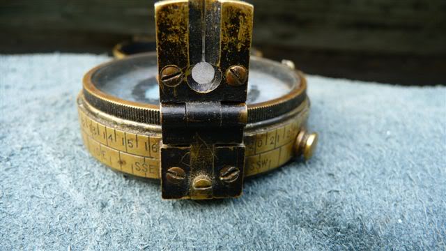

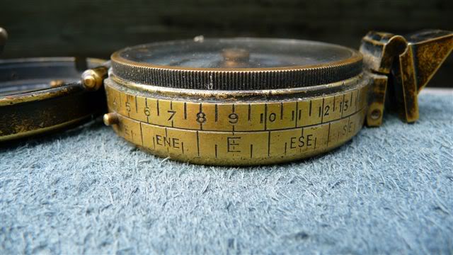

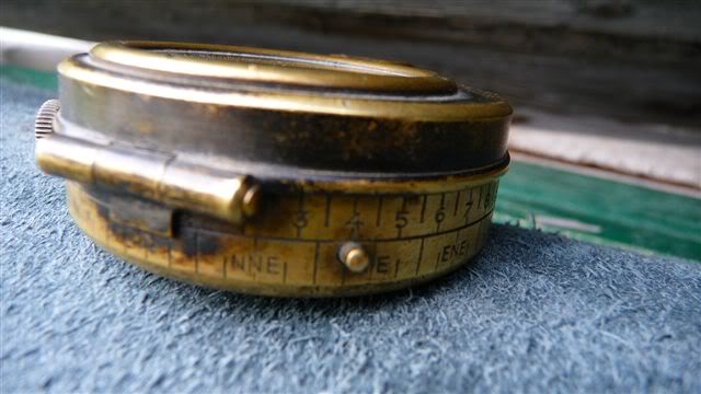

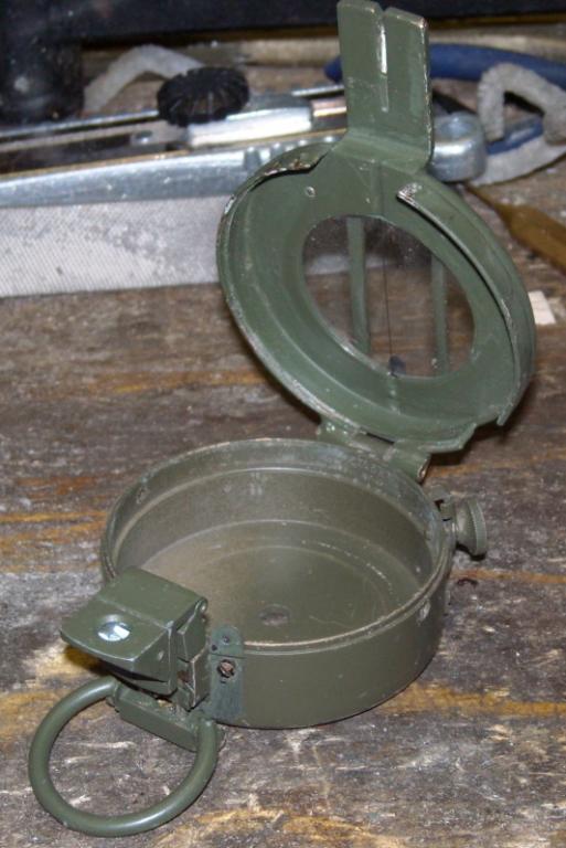

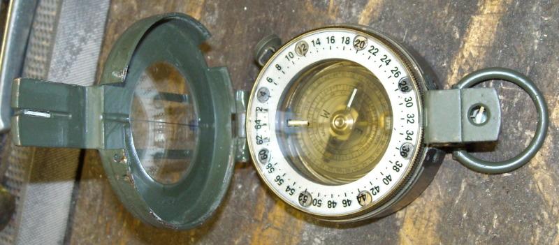

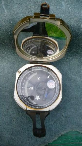

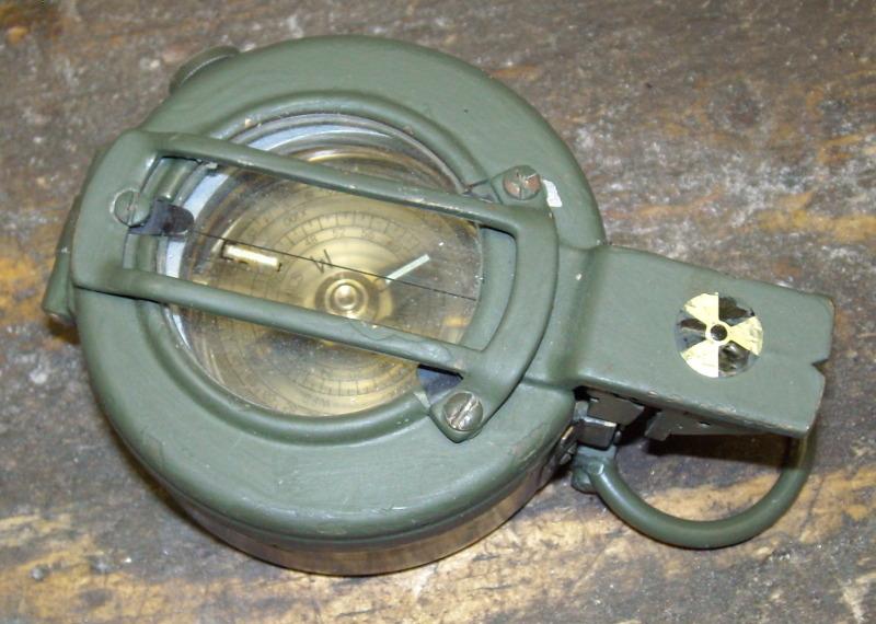

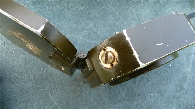

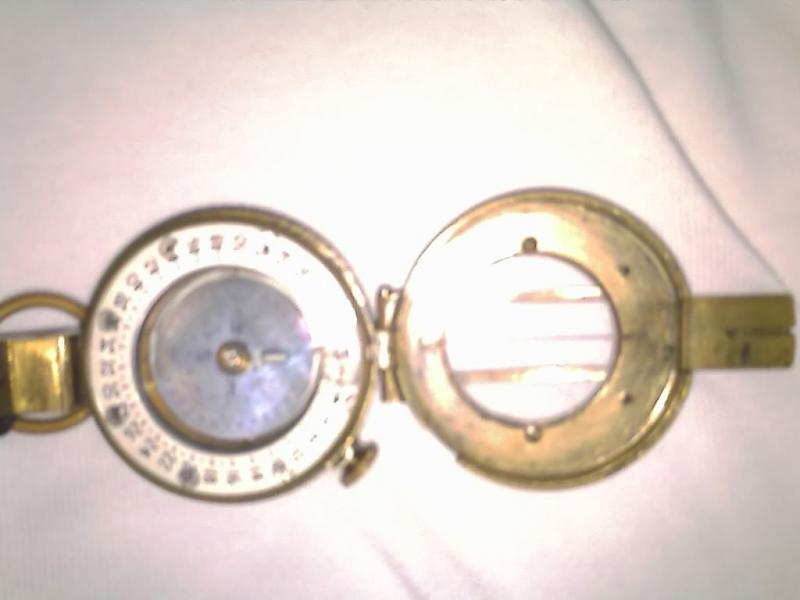

    Well, I got given an estate MkIII compass made by the Canadianicon Kodak Company in 1942 and it was in pretty sorry shape. I sent it off to Paul Crespel at Trade Mark London for restoration and I think it came back looking pretty good.
    It's not totally period looking any longer though as CKC used a LOT of radium - far more than Francis Barker did in the UKicon-made MkIII compasses and it was actually at unsafe levels - over 29 micro-sieverts/hr. 3 micro-sieverts/hr is considered hazardous to your health. So I had all the original radium cleaned out and it's now down to about 1.15 micro-sieverts/hr which is a safe level and the lights are now all tritium capsules - not radium paint.
    Before:
    After:

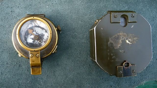

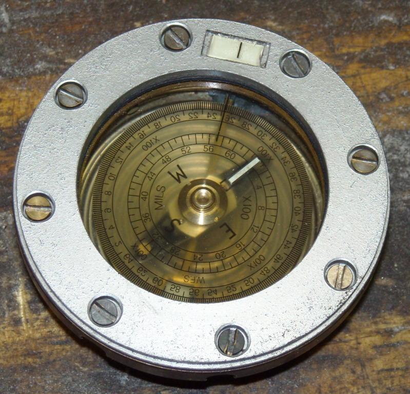

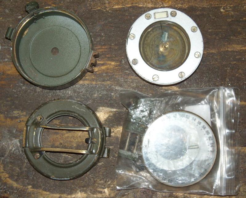

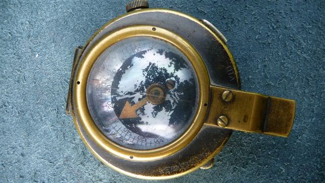

    The Original dial had to be replaced with a new one made by Francis Barker (they are interchangeable - CKC made the MkIII under license from FB). Paul tells me at some point in the compass' history some quartermaster had attempted to "repair" the instrument when the kerosene damping fluid leaked out, probably in the 1950's before the compass left Canadian service. The "gasket" was redone using putty and the ham-fisted oaf had also cracked the dial. The restoration also required a new viewing glass as the original had been scratched up with a screwdriver from the bad repair job.
    Here's the original dial and glass:
