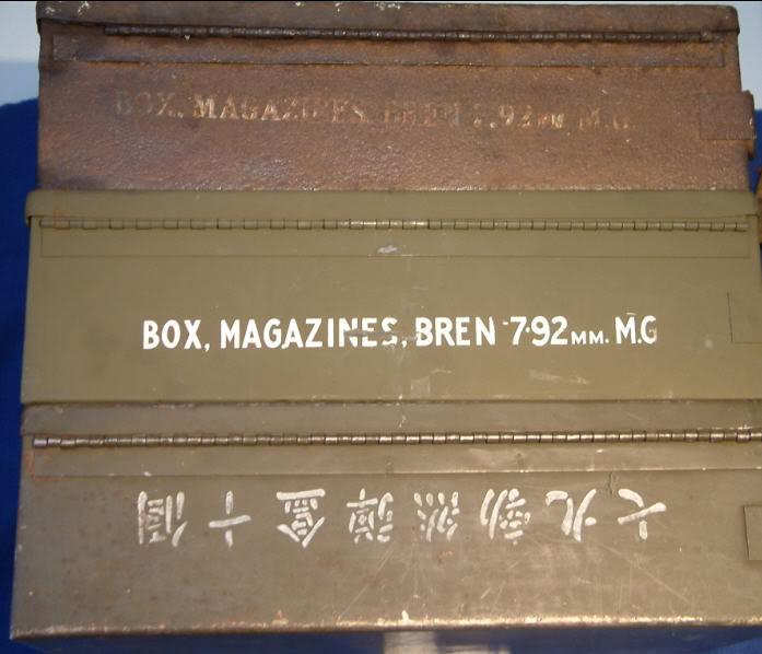

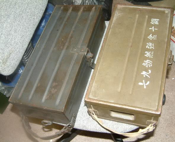

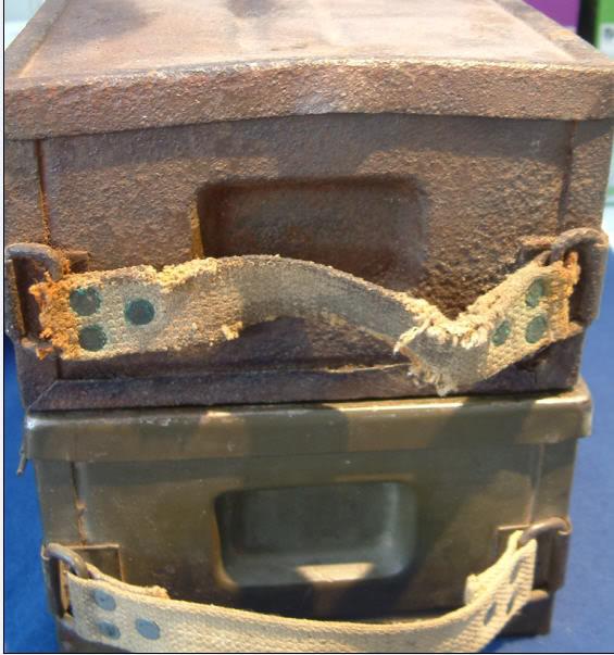

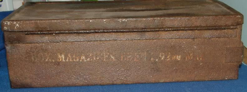

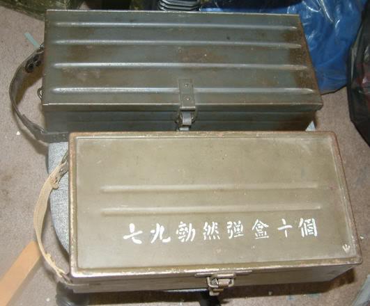

    Theres a version with chinese script as well as Engish, I believe theres also 2 diffrent handles. Kev G knows quite a bit about these.
    These are some photos that were previously posted by Kev.

    That top box looks like it was on the beach with BP's T&E gear!
    If you want to preserve that T&E gear BP, you ought to leave it in a tin of old engine oil for 2 years while the salt leeches out. Then, once a month or so, get the oil boiling hot and allow it to cool

    If you want to store ZB mags wouldn't you rather look out for a specific (13 mag) ZB mag box ,rather than the 10 mag 7.92 box ?
    I have a spare 'post war' one as per Ebay if you want to PM me.
    None of these boxes from the US storage depot or the same type from Canadaicon have handles on them though.They are also not the same construction as the WW2 type for China though externaly they will pass off.
    The rusty 7.92 box is probably the most interesting one regardless of it's condition as it is the same construction as the WW2 Chinese boxes but it is in English with a more stylised font.This is the only one of this type I have seen.
