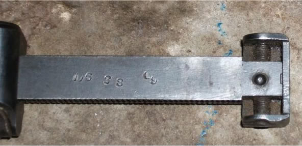

    I just picked up a 1913 BSA No.1 Mk.III (no star - which surprised me, seeming the volley sights have been removed and the forend replaced, maybe when the barrel was replaced in 1922). The windage adjustment has been locked in place on the rear sight leaf by someone using a punch. This is all well and good, but some monkey decided to try and adjust windage and broke the knob off (not me, I hasten to add). I was wondering what my options may be, besides replacing the rear sight leaf completely (I would like to keep the numbers matching as much as possible). I was thinking of having the thread drilled out, and modify another adjusting knob (cut most of the threaded part off, and having the rest of the threaded portion turned down to fit the hole), then using epoxy to fit the adjusting knob in place. It would only be cosmetic, but as the adjusting thread can't be turned now anyway, any fix would only be cosmetic. Anyone else have experience of this problem and ways to fix it?

    Usually the adjustment is locked in place with a cross pin in the middle of the sight base platform thingy. I'd think you could do a non-functioning repair fairly easily.

    Spinecracker, I am fairly conversant with the SMLE adjustable sight and have disassembled several for repair. First, remove the rear sight from the rifle. Lock the sight up snug in a padded vise with the bottom of the sight facing upward towards you. You will quickly spot the windage adjustment screw. Get out your Dremel tool and cut the screw in two on both sides of the sight leaf. Separate sight from sight leaf. Remove old windage screw from sight base, even if you got to dog it out. You are now ready to reassemble your nonfunctional sight that'll look correct.

    A few photos of a crosspinned windage adjustable sight:
    Won't help the repair process, but just to clarify the issue for those that haven't encountered it before.

    I need to sort out photos, but the rear sight I have is not pinned. Someone used a punch to dent the top of the rear sight in the region of the screw in several places to deform the threads and hence stop it from being moved. Looking at jmoore's photos, all I may need to do is clean up the metal where the knob was broken off with a Dremel, then reblue and weather the parts to match the rest. If so, then all I need is a cut off to put this rifle back the way it was between the wars (last year stamp on the buttsocket behind the safety is '36). I would love to know where this rifle has been, as there is no "sold out of service" mark.
