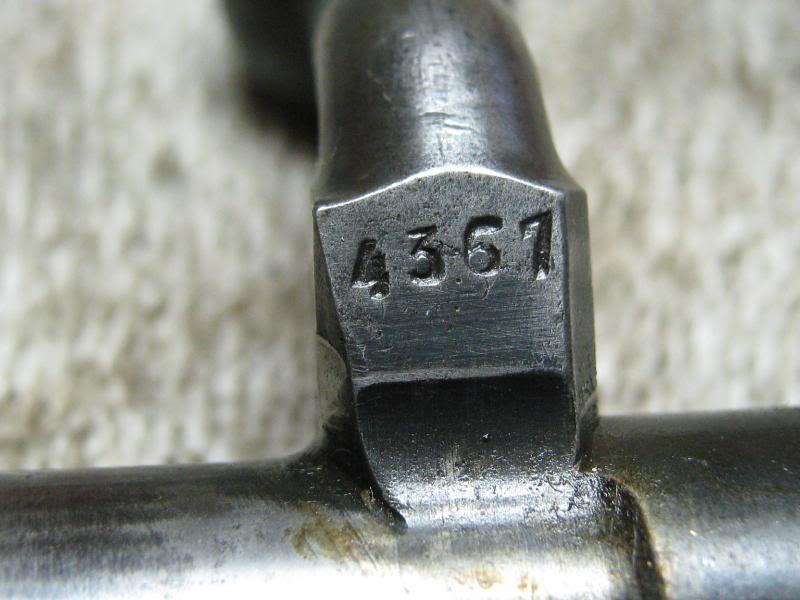

    Nice MO, thanks for sharing. Your bolt looks ok, but can't tell for sure. You would need to show the firing proof on the back of the bolt handle. Also you need to see the proofs under the handle. Anyway nice k98. Bill

    The cleaning rod is right at 12 1/2". Here is some bolt pictures. After taking the bolt apart it appears that it is mostly Germanicon and matching except for the safety and maybe the extractor(it has no markings at all). Besides the serial number there are no other marks of any kind on any of the pieces besides the safety.

    I did some checking and the bolt assembly could be Mauser Oberndorf from mid 1944 till the end of the War, the bolt components from that period at MO were serial-ed but did not have Waffenampts stamped on them. The safeties had both serial number and Waffenampts until mid 1942 when it only had the serial number and then in early 1944 the serial number was also dropped.
