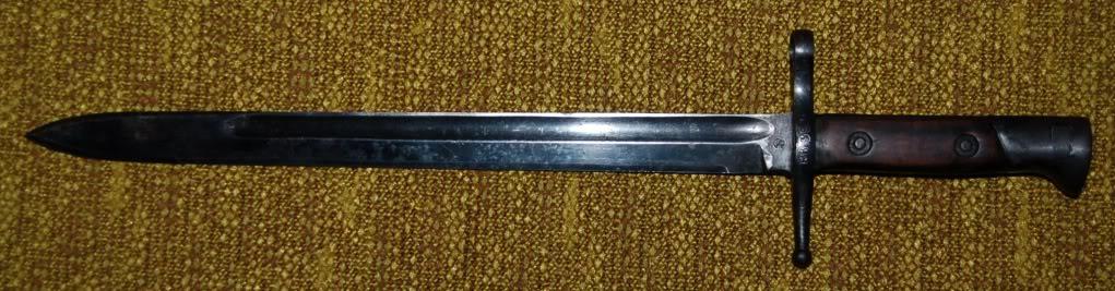

    I picked up a carcano bayonet off ebay that came yesterday. Can't seem to find much information on these at all. Condition is fair, it appears to have been arsenal refinished at some point. The blade has been blued but also shows signs of earlier pitting. It's stamped RB389 on the cross guard and has an R superimposed over a C on the blade. Has three small letters on the flat of the cross guard the first which I can't make out, the second and third are P and S. It has one other mark on the top of the handle metal that I can't make out.
    I'm just a casual collector trying to get one representative piece from each nation during the wars but would like to know a little of the history behind them. What little I could find on this seems to indicate that it is of WWI vintage due to the cross guard markings

    Sorry, I know what it is. It's an M1891, common version. I'm just curious about whether the markings identify where it was made. I can't find any sites that list makers marks.

    Photos:

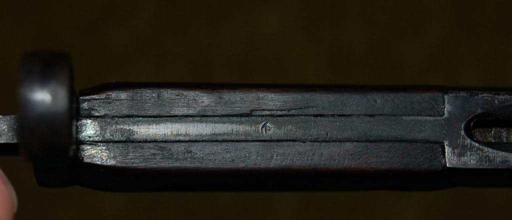

    Aragorn, please position your baxonet with the hilt up and the blade down.
    Now take another look at the marking on the ricasso:
    That looks like an R superimposed, and slightly above a C. This is the monogram for the manufacturer ROCCA. CORRECTION Renato Castelli, not Rocca, see later posting!ROCCA made M91 bayonets in WWII for use with the M91/41

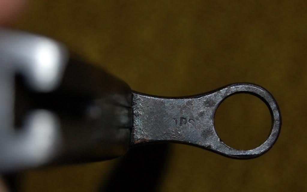

    On the crosspiece, beteween the muzzle ring and the grip, we see a clear PS.
    This is a stamp from the component supplier PS (full name unknown), also known as a supplier of parts in WWII, in particular bayonets, up to 1942.
    The mark in front of that bothers me. It could be a worn or badly struck O (letter) or 0 (number). Either way, it lines up so badly with the PS, that I doubt it is a part of the PS stamp. Is thare any trace of further numbers in front of that - it could be the remains of a year stamp "1940".

    On the crosspiece, the RB 389** would have been a matrix number back in WWI, with the format A xxxx or AB xxxx as previously described in identifying a Carcano on the General Discussion forum. But in WWII this system seems to have broken down, certainly for accessories, and the marking on the cross piece was often a manufacturers name (batch?)/number stamp. It is not a regimental marking - the Italians did not use a regimental marking system.

    My best guess: an M91 bayonet from ROCCA, I]CORRECTION Renato Castelli, not Rocca, see later posting![/I]made in 1941 (possibly 1942) from parts from more than one supplier (i.e. whatever was in the bin), probably for use with an M91/41.

    I've seen ROCCA WWII produced bayonets for production year 1941, 1942 and 1943. They are marked ROCCA with the date stamp on the crosspiece with no mark on the ricasso. The bluing appears to be a post war refurbishment, whether this was post WWI or post WWII I have no idea. It does have old pitting in spots on the blade. RC being the monogram for ROCCA makes sense but it doesn't match known examples.
