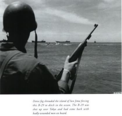

    Quote Originally Posted by INLAND44 View Post
    Bayo lugs and adjustable sights made it to the Pacific. See picture from the battle for Iwo Jima. This carbine has the bayo lug and appears to have the flip sight.
    http://i209.photobucket.com/albums/b...bayonetlug.jpg
    Thaks Inland44.... I appreciate it!! I have what I feel to be a completely correct 4-45 Inland with Bayo lug and adjustable rear sight. (Ser 71xxxxx). Love that image!
    Thanks so much! That's a great image! You don't see many for sure.. but since pretty much all the books mention these late changes were implented from about mid 44 til early 45, it makes sense that at least some of them would've made it to the field.

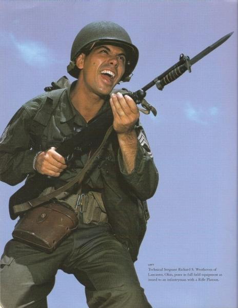

    Sgt Westhoven has a very scarce pattern of bayonet lug there. I wonder if he has it as a vet bring back? Now, to find him...

    That looks like a HOWA bayo lug (type two band). Could be a post war Jaspanese rebuild. He also looks like he has a 1945 pack on.
    My FIL served in the ocupation force in Japanicon. We have some staged photos that are simular. One almost identical, except he is holding a Garandicon. So I wonder if the photo is post war. JMT.....Frank

    Quote Originally Posted by frankderrico View Post
    Rear sight looks funny as well, as well as the sling attachment--it doesn't seem to go into the sling well on the correct side of the stock.
