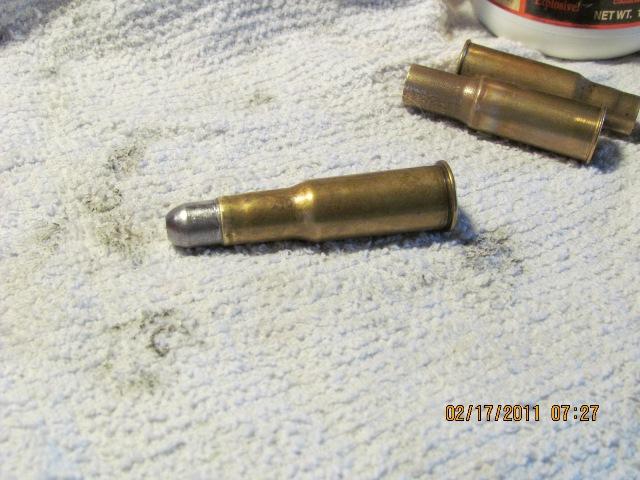

    I made it to the range with my MkIV Saturday. I loaded 3 rounds, 1 CBC 24 ga brass with 60 grains of Goex 2F, dryer lint, card wad, wool wad, card wad, grease cookie, 2 card wads and a .468 dip lubed RCBS bullet, case neck sized only and lightly crimped. 2 Jamison brass, same load. From the bench, 100 yards.
    Next up was 60 grains of APP/Schockley Gold 2F, dryer lint, card wad, dip lubed .468 RCBS
    Last bench load was 60 grs of APP, dryer lint, card wad, .458/405 Lee and .458/500 Lee, paper patched, dip lubed.
    I had 4 rounds of the .468's left and decided to try my luck off hand.
    Clean up was a breeze compared to my experience shooting all black in the past. One hour and I had the rifle and brass clean.

    I use Lee dies and try not to work the brass anymore than I have to. If I am using more than one rifle, the MkII & the MkIV, then I have to full length resize. I will say that the MkII doesn't do as well as the MkIV with this load.
    45grains of Schockley Gold 2F by weight, 60 grains by black powder adjustable volumnmetric powder measure. One that I have used for over 40 years. The APP 2F looks to me like maybe
    1F of the real black.
    I used the brass powder measure and poured the powder into my scale pan to see what the actual weight is.
    Jamison or CBC brass
    ---------- Post added at 05:29 PM ---------- Previous post was at 05:25 PM ----------
    My computer started acting up so had to post and then continue.

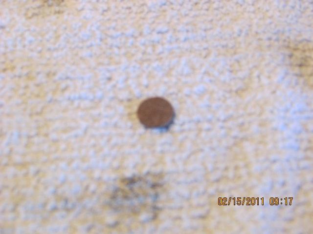

    5 grains of dryer lint
    card wad
    dip lubed RCBS .468/485 grain bullet

    Charge the case, feed the lint into the case, don't pack it down and leave it in the neck.
    put the card wad on top of the lint and then let the bullet move it down in the case neck. Again, it is just a filler, don't want to pack it in.
