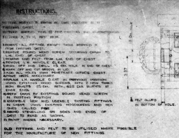

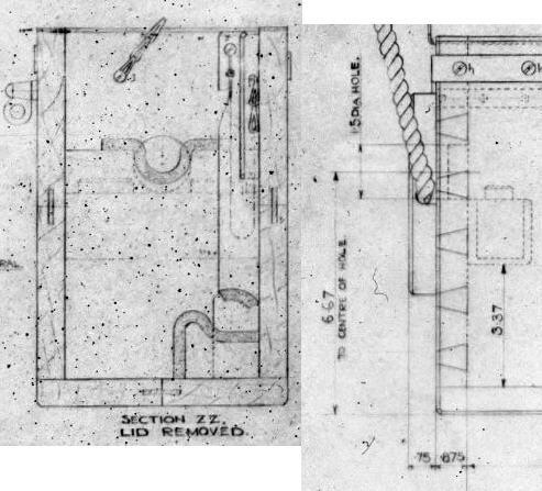

    Not disputing Peters comments on the cut out to take the early MK2 butt plate with the shoulder rest it's just I haven't got a drawing for it.
    DDE 2998 (2 sheets),CHEST BREN MKII to guide conversion of CHEST BREN MKI* shows that replacement internal gun rest pieces were used to centre the gun and to move some forward.Rather than the end timber being relieved for the butt plate it shows that a counter bored hole for the flash hider is drilled in the opposite end.
    DDE 3013 (2 sheets) for new made MKII chests also shows the 1.5 inch hole counter bored for the flash hider.
    ATB Kevin

    If you have a UKicon MK2 Monotype I would modify as per DDE drawings allready mentioned for conversions from MKI and new made MK2 chests.
    The drawings are much too big to display here but can put them on a CD if it will help ?
    You will need to make various new internal pieces so the gun is centred in the chest as opposed to being off set to the rear (hinge side) as well as other modifications.
    The hole for the flash hider and centred rests can be seen in the partial drawing below.
    ATB Kevin

    Quote Originally Posted by Kev G View Post
    The drawings are much too big to display here but can put them on a CD if it will help?
    Thanks, but I don't want to modify it - with my woodworking skills it would probably all end in tears...
    However, the pictures are helpful in what to look out for should I bump into a Mk2 chest on my travels.
