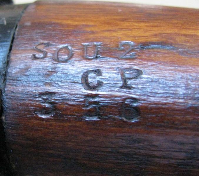

    Yep, just the rack numbers. But I'd like to see the oither parts of the SOU that you can JUST see under the small of the butt. That's a bit of history that I might be able to unravel for you................ Armourers knew all of these markings and yours.......................................

    Hi,
    Thanks for looking at this :-)
    Here is the SOU number
  5. #5
    Today @ 06:47 AM
    16,672
    06-12-2025
    03:50 PM
    Yours was given a major Base Workshop overhaul - pretty well a FTR but without the in-depth body jig examination at 18 Base Workshops at Bovington Camp in Dorset in March 1956. CP was the examiner.
    SOU 2 was their mark that indicated Southern Command. I suspect that as the mark is still clear, it was a 'programme' where, say, 500 used rifles are taken from Ordnance or withdrawn from a unit being sent abroad and returned to war reserve stockpiles. There, they'll be put into what we called 'deep pres' or deep preservation and stored for decades. But that's just a guess.
    Anyway, there's a bit of its history......................
