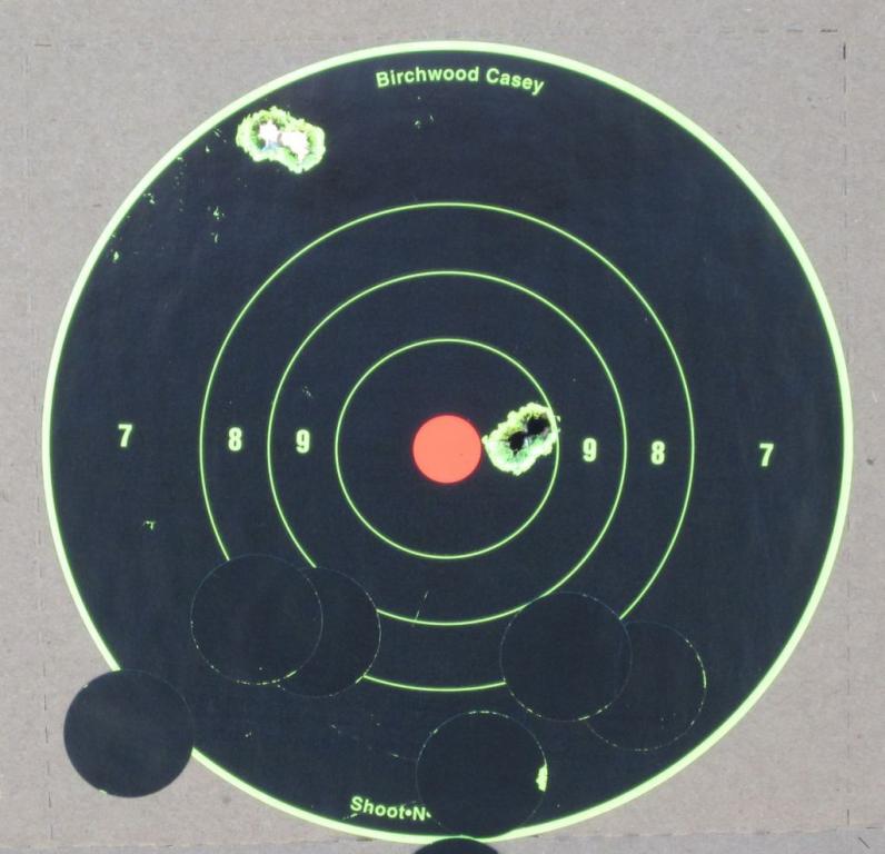

    This is the result with the first 5 rounds yesterday at 100 yards -

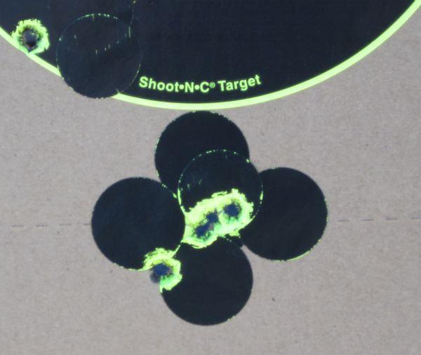

    Arrgghhh!!!! The dreaded vertical stringing. The hole on the right was a warm-up shot. Just in case I was messing up, I tried another 4 rounds (was getting low on ammo), same point of aim, to try and get a consensus of opinion -
    Now I am thinking "what is going on???". The answer? The rifle had to settle into the bedding work I had done. Point of aim was dead centre on the middle of the cross. At this point, I had not adjusted the scope whatsoever, so it was a total fluke that my prior zeroing attempts were spot on. I was just slightly pleased at this time

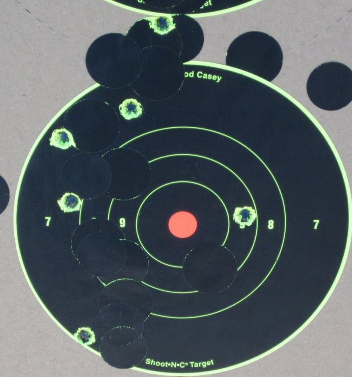

    Next was trying the rifle out at 200 yards, point of aim = centre of target -
    The 2 shots high and left were after roughly adjusting for changes in bullet trajectory, the second 2 rounds (the last of my handloaded .303) were spot on. More dancing bananas....
