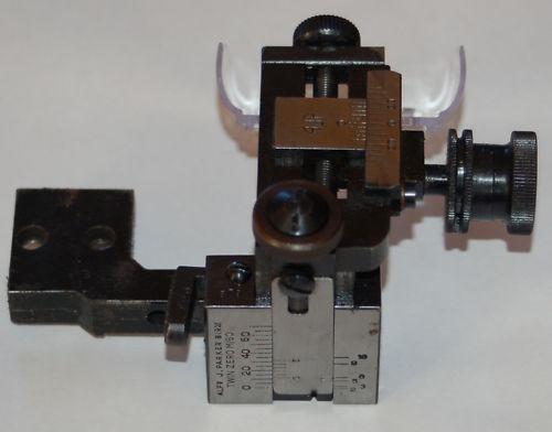

    This is a picture of the "Twin Zero M80".

    If any ones got Edna Parkers book "A century of Sights & Sighting Aids" the M80 is on page 39
    It is described as the "1980s model sight that will adapt to numerous actions & brackets"
    Regards Simon
