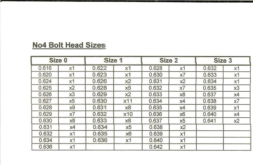

    This was a table of bolt head sizes I produced 2 or 4 years ago - I've kept it going and now have over 200 examples (but this is the original version)

    That's a great chart on bolthead sizes too. It just proves what we Armourers already knew. That the number on the head really didn't count for much at all. It was the actual length that did matter.
    For example, we would get a rifle that was just about ready to fail on a No3 bolt head when, lo and behold, you'd swop bolt heads from a huge pile in a box, and it'd successfully CHS it on a No2!.
    The moral of this is don't dispair when it seems to be on its last legs.
    The same applied to Bren barrel nuts and L1A1 locking shoulders although generally speaking, the L1A1 locking shoulders were always closer to the specification. But No4 boltheads were nototious for their sizing..........................
