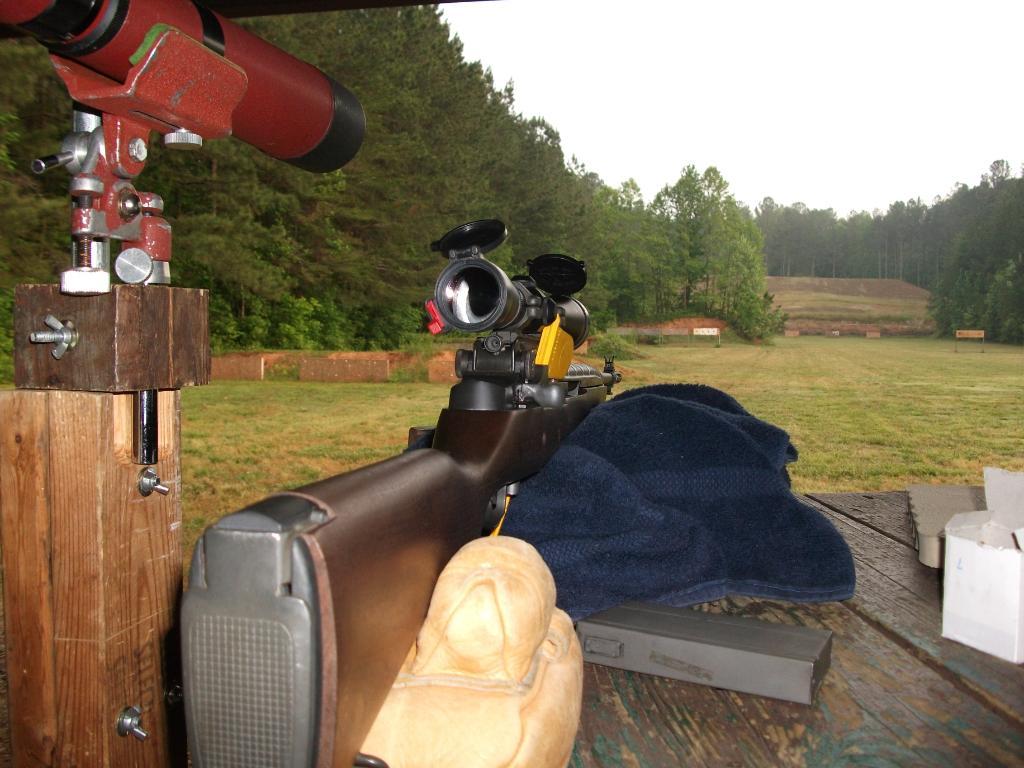

Warm up:
M1a 134918 a thoroughly abused and monkeyed with rifle that's back to a surprisingly conventional configuration.
TRW USGI barrel witth several thousand rounds through it that I know about (because I did it).
SAI "plump" stock that has a favorite "feel". -Note: no bedding(!), but good fore end tension and trigger group clamping pressure.
Leupold Ultra M2 10x on an old ARMS 18 and 19 mounting set.
Std GI flash hider (not reamed)
Modded trigger hsg and hammer as posted elsewhere on other old threads.
Not very Japanese so far, but it shot so well after having JUST been thrown back into the wood stock from a JAE unit, that details might useful before I forget them....
No rezero, no warm up sighters, just ten rounds:
Note the fancy bench rest set-up. Operator was wearing two T-shirts (a little cool) and fired LH.
1st five rounds fired after stock swap.
Next five. Note that the zero was previously spot on with this ammo whilst in the JAE stock. Mighty good group for a tired chrome lined bored rifle. But it isn't unusual!
I don't deserve it, but...
