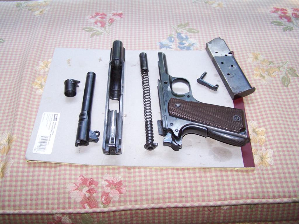

    And here they are taken apart!

    The holster's a Boyt second war issue. Now I can see the US on it. The mark I saw on the 1911 was the rampant stallion himself. Left rear. I forgot about that marking. Nice catch.
