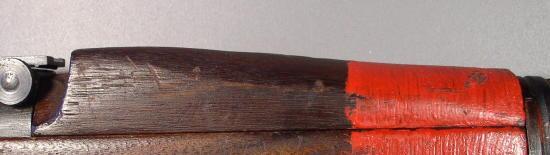

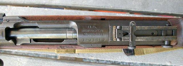

    HI, New to the forum.
    I am considering purchasing what looks to be a very nice late issue Rem. 1903.
    THe seller is a friend so I will have access to it for better photos in the next few days, but just snapped a few with my phone to begin my research.
    The serial number jives with the FJA and RA on the stock. The odd letters are the FFF and 002 on the opposite side of the stock.
    Anyone know what this means?
    In my first once over, I could not find an "R" on the extractor. It may be hidden by dried grease and will be examining all sides of that extractor more carefully next time. But here is a broader question:
    Exactly what parts on this rifle should have an "R" on them? WHat parts are acceptable without one (without affecting value)?
    Lastly for this post, the sling looks to be very original, and bares a faint 1942 stamped into it.
    (Not pictured) Does this look to be an orig?

    Another thought: I know this is a late Remington, but is this considered a transitional gun? If so, should it have all the same "R" markings as earlier Rem models?

    It looks Ok to me. Many of these went to the US Navy, perhaps Navy markings on stock? What is asking price?

    Looks like a nice rifle. How is the bore? The M1907 sling adds $100, if in good shape. Looks like you have alot of milled parts there, might be original, might not. Most all of the parts should be marked "R". Is the trigger guard marked?
    Is the stock relieved for the A3 handguard ring?
    Even if a few parts are not original, the rifle looks good. If the bore is nice, I would have not problem with a $750 pricetag.

    The markings (FJA - RA) indicate the stock was taken from a late Remington M1903A3, probably a year later. The rifle is not necessarily a "transitional" rifle, but should have Remington M1903 parts. I can't tell much from the pictures, except that the handguard is also a replacement and the rifle has probably been refinished. If the bore is in good condition, I would think the price is a decent one, but not a steal.

    Mr. Findley's knowledge on the Remington M1903 is as faulty as his "restored" stock markings! The RA was not added to Remington M1903s and only to later Remington M1903A3s.
    The shape of the handguard is wrong for a Remington M1903 - an original handguard was a slightly modified high hump-type. I can post a picture, if desired.
    If you look on either side of the stock nearest the forward end of the receiver, you should see a "slot" on either side. That is for the 03A3 handguard ring, which held the 03A3 handguard in place.
    The 11-42 barrel (if a Remington), is probably correct.
