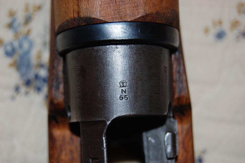

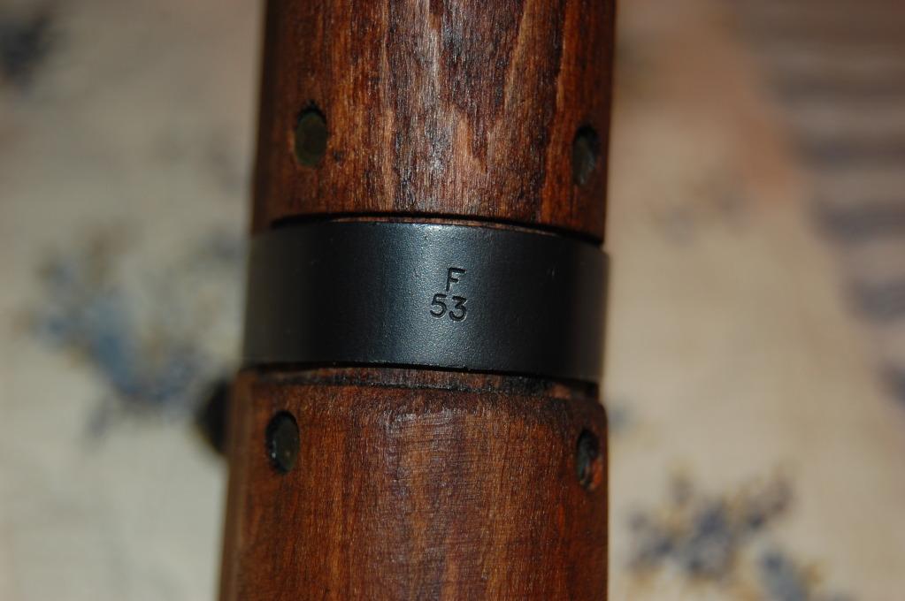

    I'm trying to identify a few marks on a No.4 MkI* and would appreciate any information I can get on them. Thanks.

    Put your hands in your pocket and buy Skennertons book on the subject. Not expensive and available from Brian at BDLicon Ltd who advertises on this site. But as an Armourers rule of thumb, anything with an F in the format originates from the old Ministry of Suppply facory number 6 at Fazakerley in Englandicon

    From what I can see I'd guess it's a Savage that's been through FTR at ROF Fazakerley. I can see the importer's "made in USAicon" stamp and the "U" of U.S. Property.

    It's a 1942 Savage No.4 MkI*. The stock is definitely not original. There is a CE 1967 stamp on the top and bottom of the forend cap. I've read where that might be a South African stamp? The forend swivel doesn't look to be original either. The rear swivel is worn like the receiver and has the Savage stamp, so I figure that might be original. The buttplate is not brass, so I believe that might not be original either. I figured the stamp in the first pic was an inspectors mark, but I was hoping maybe I could track down who actually made that stamp and where. I'm new to Enfields, so I'm trying to find out as much as I can about what I have.

    Yup, it's stocked up with South African contract beech.

    N65 is a wartime manufacturers code for Sigmund Pumps Ltd. Gateshead. However, in this case it's probably an inspector's stamp like the other one

    I'd guess it's been restocked here in the USAicon since I don't see a "U Broad Arrow" South african ownership mark which is usually stamped on the top of the receiver ring. The South African wood was available in quantity in Canadaicon and the USA for quite a while. I still have a couple of new sets left here with Britishicon beech butts. I had Mk.2 forends too complete with the reinforcing bolt and nut up until last year when I finally ran out of them. Many were selling them less the metal hardware and those little bolts and nuts are very hard to find.
