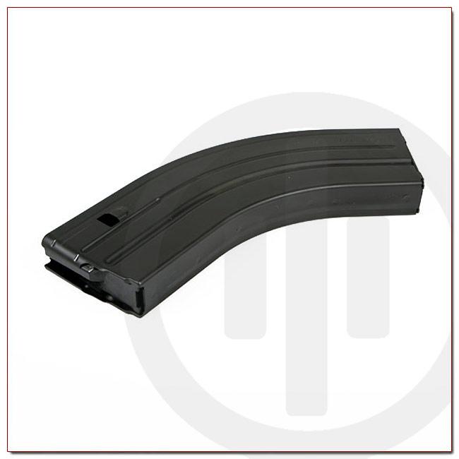

    5.45 is very cheap for the surplus, but it is corrosive. All the info I've read on the web says that magazines are the real weak point for that caliber in the AR. Finding ones that work well may be difficult.
    I've also read that 7.62x39 chambered AR's have a higher incidence of bolt breakage due to the larger base diameter and the corresponding reduction in material in the bolt. These ASC mags are supposed to work well, though.
    I was looking into a 7.62 AR as 10 round "pistol" mags are available for that caliber in Canadaicon, now. Instead I just went with a mag well conversion on one of my VZ 58 to use the same mags. No worry about parts breakage that way.

    As Stevo notes, the 7.62x39 AR mags are problematic. (That's a nice way of saying they're hammered dog poo!) Not a thing wrong with 5,56. If it's not enough gun, than get a 7.62x51. If you want cheap shooting get a .22 rim fire AR. Pays for itself fairly quickly.

    Actually, I said it's the 5.45 mags that are problematic. The ASC 7.62x39 mags are supposed to be quite good.

    I've seen more functional 5,45 ARs than 7,62x39s. And those aren't common. That deep, straight mag well just isn't well suited for the more tapered Sovieticon rounds.
