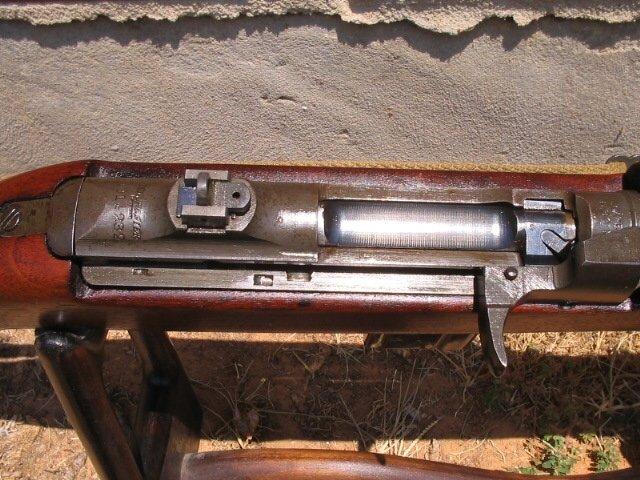

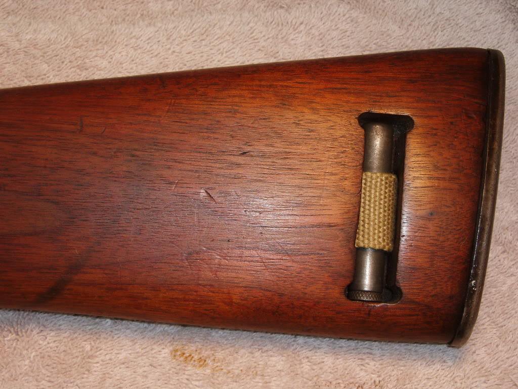

    1014232 has an unmarked stock along with several unmarked internal parts
    Today @ 08:32 AM
    Central Wisconsin
    1,647
    Frank Derrico
    07-01-2025
    05:55 PM

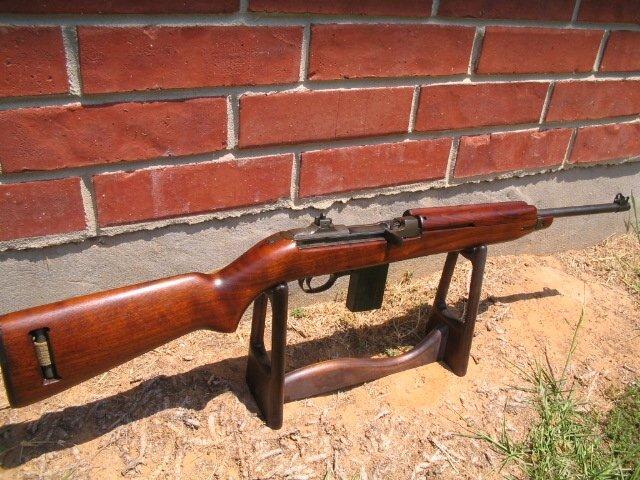

    Here is 1013812 no cartouches anyware. There is a number stamp in the bridge. Would have to get it out. If you need a pic of the stamp let me know.
    Only 420 away from David's. Made the same Day? Got to like the blued bolts and dated barrels.
    Best Regards.....Frank
    Attachment 33977Attachment 33978Attachment 33976Attachment 33979Attachment 33975
  8. Thank You to frankderrico For This Useful Post:
    dbarn's Avatar
    04-05-2017 @ 10:46 PM
    412
    07-01-2025
    05:55 PM
    Frank. That is just too cool. Thanks very much for sharing.
    This one is marked 162 on the bridge and C on the right internal flat of the receiver area. Additionally the unmarked parts include the bolt, extractor, hammer, trigger, and sear.
    Would love to see additional photos when you have the chance. Best regards.
    BTW, does the club have a data sheet on yours?
