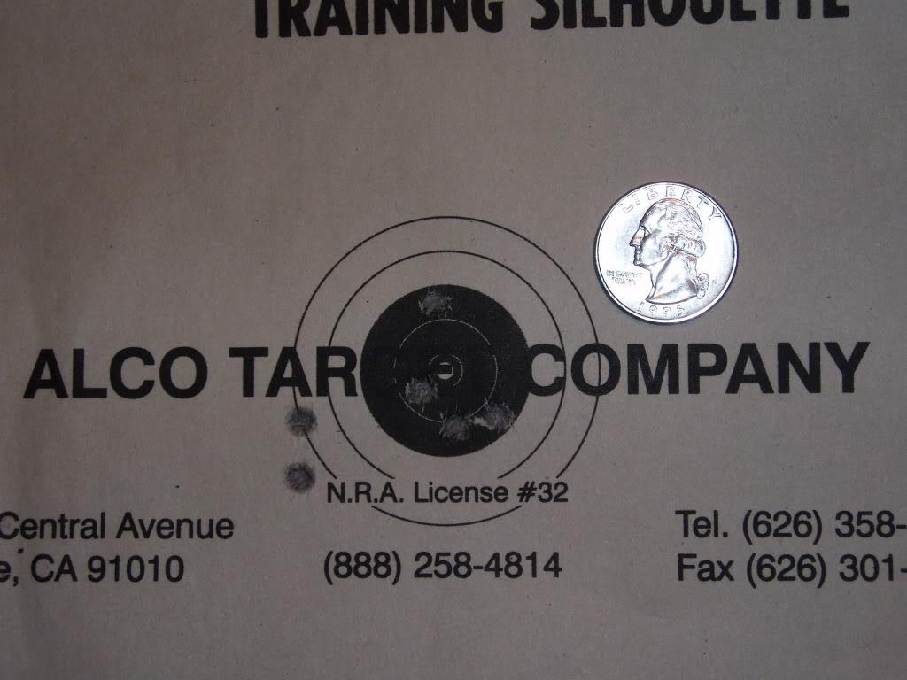

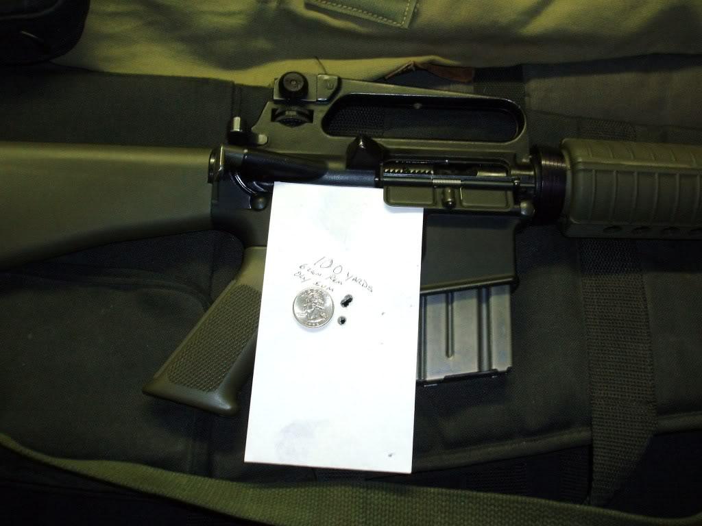

    I have an Olympic Arms SUM that is unbelievably accurate!
    These are 100 yards
    Bill Hollinger
  13. #10

    Nice groups Bill! I am ready for spring & hope to participate in some matches.
    Tom
