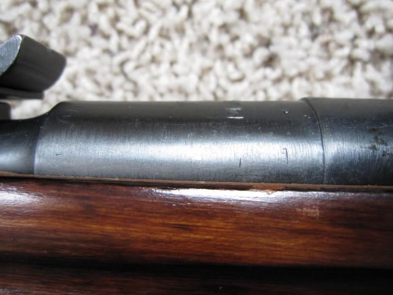

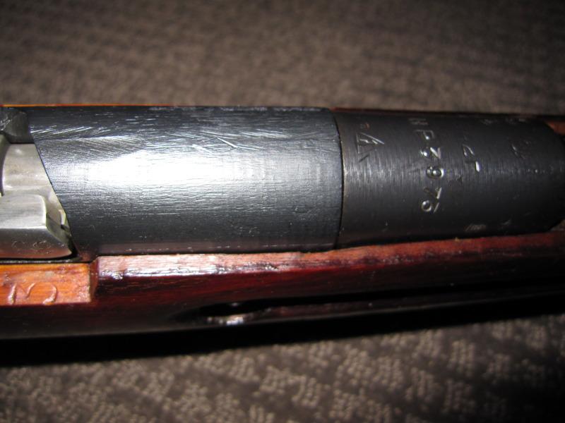

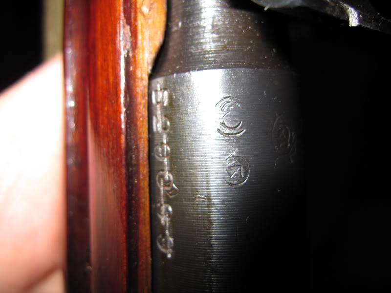

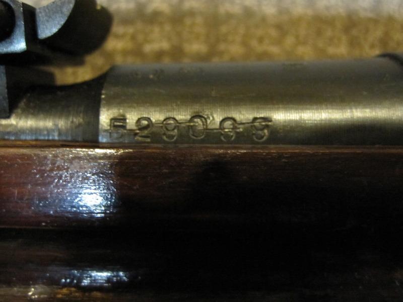

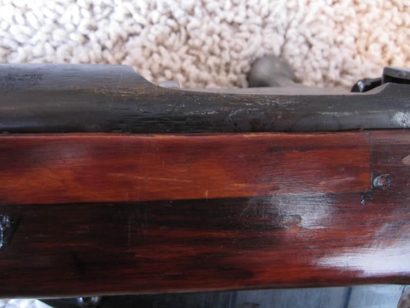

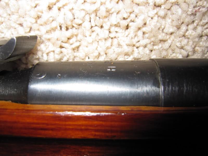

    I'm not an expert on M91-30 sniper history, but you want to look for a rifle that has a dull colored finish, with patterns in the wood stock that suggests the camoflage of a tiger shark. {that's what my IZZY-1943, M91-30 sniper rifle looks like} In each imported crate of 100, M91-30's, possibly 3 of them are sniper's, converted back to infantry ---but with the two drill holes, for the scope mount, drilled into the left side of the reciever.
    On top of the barrel in front of the reciever you will see the factory marking's, and year that the rifle was made. On the left side of the barrel in front of the reciever, you will see the new laser etched marking's of the importer such as Century Arms. Just to the left and below of the laser etching's, you will see an old looking serial number that has been stamped out buy a thin single chisel mark across the center of the numbers. This rifle was picked for it's accuracy, stamped with that number, made into a sniper, and converted back to an infantry rifle, when the single chisel mark was made across the serial number. The number and the chisel mark will not look new.
    A tiger shark that has been dunked in shellac, of course!
