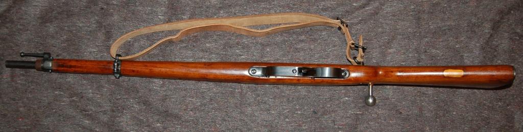

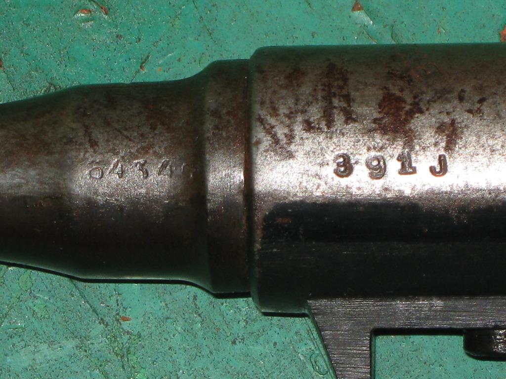

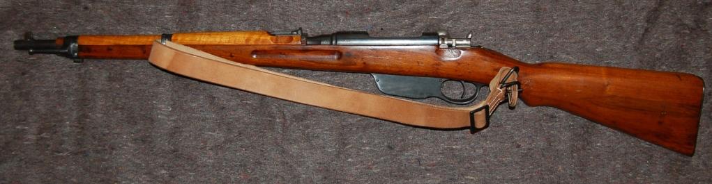

    Picked up this Steyr/Budapest M95 carbine this weekend, non import marked. H marked barrel, signifying conversion to 8x56r. Couple of questions, could this have been converted from a long rifle? There is no side sling swivel next to the butt. There is a circled E marking at the woodline, with some other marking with it. Cant make it out. There is also a plus 15 and minus 15 marking on the bottom of receiver and barrel. Would appreciate any thoughts on it, thanks!
    ---------- Post added at 02:58 PM ---------- Previous post was at 02:50 PM ----------
    Today @ 02:04 PM
    7,582
    07:32 PM
    Probably an original carbine. Infantry version made prior to 1912. Date should be stamped on the top of the barrel right about where the H is. Could be elsewhere but will only be one or two numerals. If one, it was made in 190-, if two, 189- or 191-.
    If it were a conversion, it would retain the long rifle sights. They would have been ground off and re-stamped on the bottom half. Yours has the original carbine sight. Prior to 1912 they had separate versions, one for infantry which had the swivels on the bottom, and one for the cavalry which had the swivels on the side. After 1912, they had both which is why most of the imports today have the bottom butt swivel removed and a block of wood inserted.
    I can't see the left side of the middle band. It probably does not have the side ring for a sling on it.
    The "H" simply means it was converted to the new caliber at the Budapest plant. My Budapest was converted at the Steyr plant and is stamped with an "S"

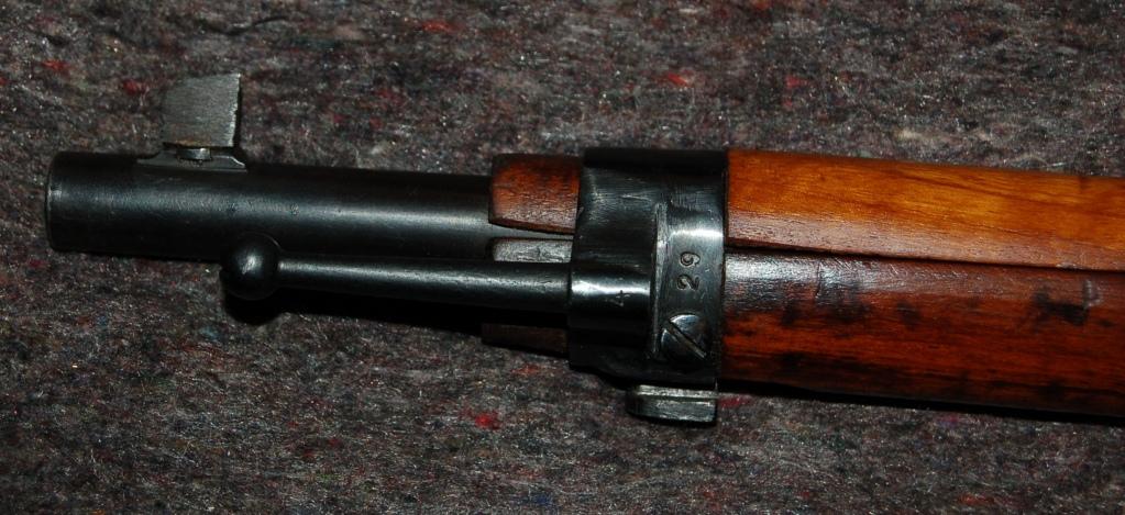

    As far as the recent imports, as far as I can understand they came from Bulgaria. Does yours have any electro pencilled numbers on the bolt?
    My carbine has no date on it of any kind. The only markings on it are the 'Budapest M95', two different numbers on barrel and receiver side, and a +15 and -15 on receiver and barrel bottom. Oh, and a circled E with something else below it.

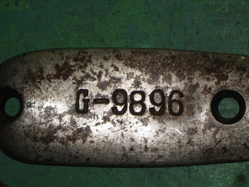

    I have never seen one of these with a numbered buttplate. Every one I have seen has had a numbered buttstock. This has none, but I can see two small 'starburst' markings on the left side of it. I would be very curious to know when this was built.
    ---------- Post added at 12:36 AM ---------- Previous post was at 12:34 AM ----------
    Oh, and yes the barrel band does have a side sling swivel. Wrist does not.

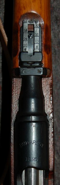

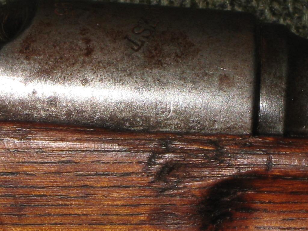

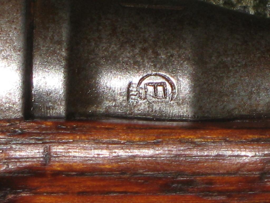

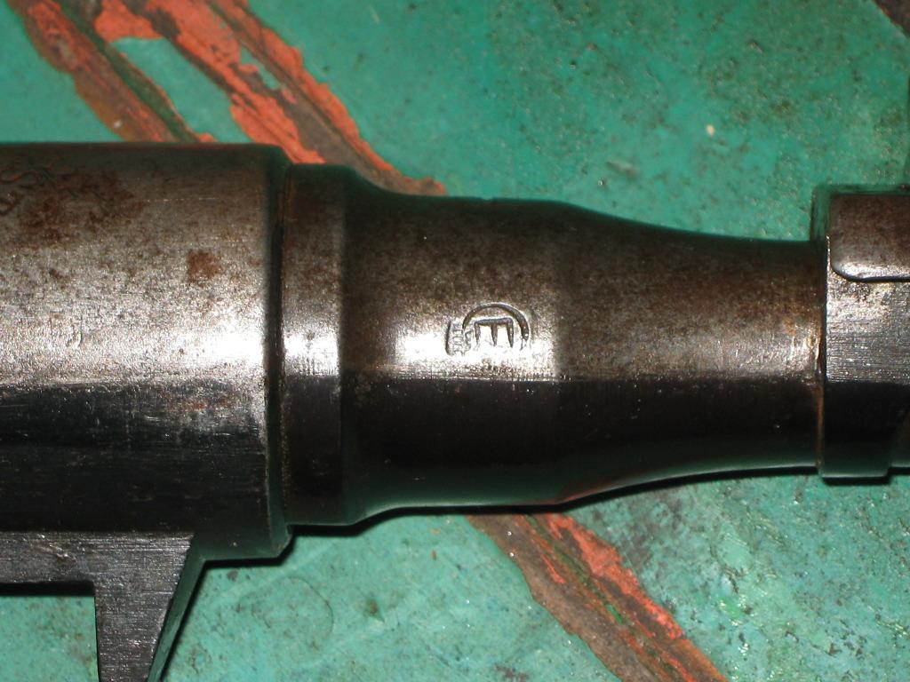

    Here's a closer look at the circle E marking, you can see something under it.....plus another marking I just found. Look familiar to anyone?
    Today @ 02:04 PM
    7,582
    07:32 PM
    Unfortunately, I don't think you'll be able to date this one. The date markings were stamped where the "H" is. They were stamped parallel to the barrel in a line of four or five symbols which include letters and sometimes a small crest. Your rifle is very worn in that area and it may have been polished off when it was reworked after WWI. I suspect the barrel is not original which may be one reason there is no date. The two numbers side by side on barrel and receiver should match. The stock may not be original either so can't date if from that. It was made prior to 1907 based on the lack of a bottom butt stock swivel. Rifle could have been made anywhere between 1895 and 1920.
    The date markings on my rifle are faint but not overstamped with the "S". The "S" was stamped higher up on the barrel. Mine reads Bc. (Austro-Hungarianicon eagle crest)17. The "Bc" is difficult to read and could be something else. I have not taken it apart to see what other markings are on it but I can see numerous crest type stamps on it along the wood line. Four number serial with one letter following match on the barrel and receiver. Electro penciled number on bolt and stamped stock matching but with two older numbers lined out. I also have matching number (last two digits) on the bayonet lug which is a little unusual. These are stamped, not electroplated. Lots of "k"s and "R"s stamped all over the small parts.

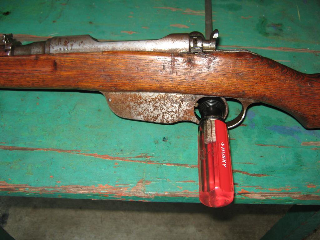

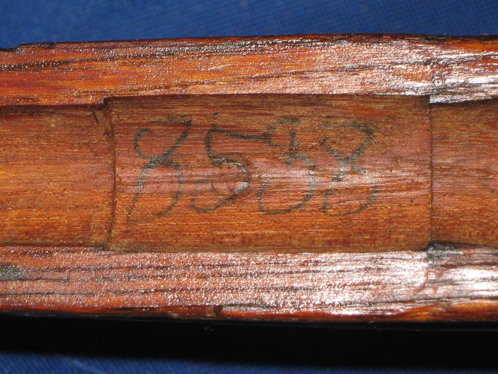

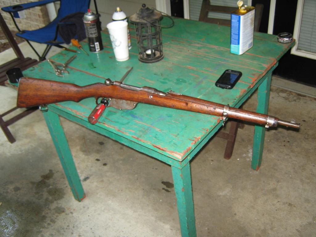

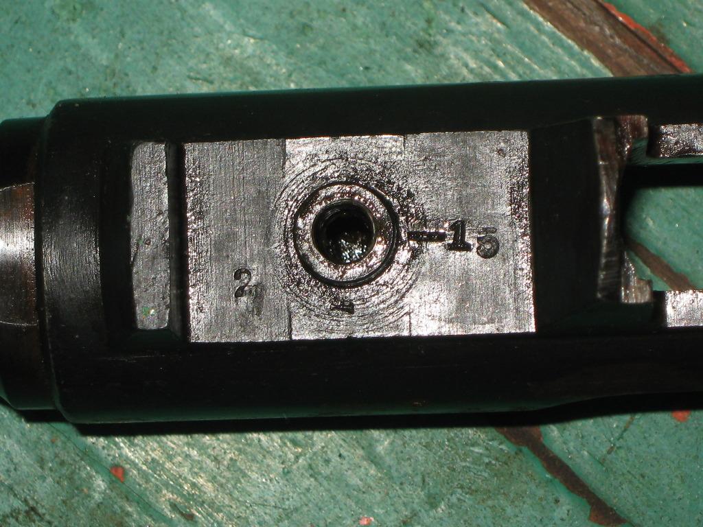

    Just took mine apart and that was pretty uneventful. Not many markings on these I guess. Mine has a +2 and a -2 on it where yours has the 15. Condition under the wood was excellent. No wear, no rust.

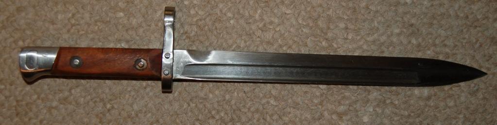

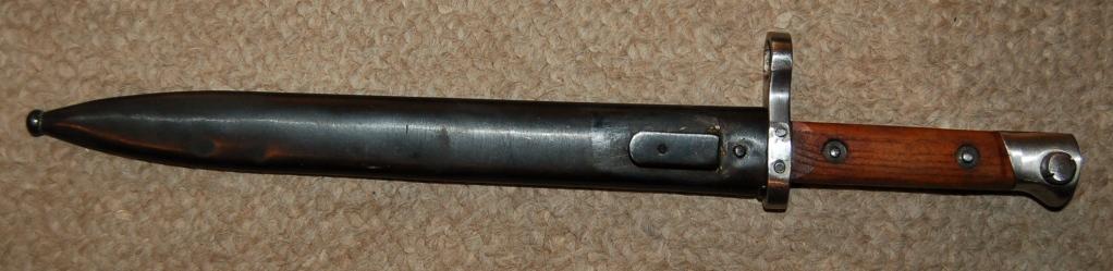

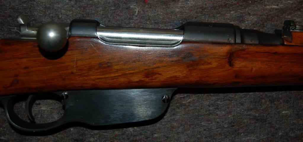

    Here's what I picked up yesterday. 1917 Budapest carbine re-chambered at the Steyr plant.

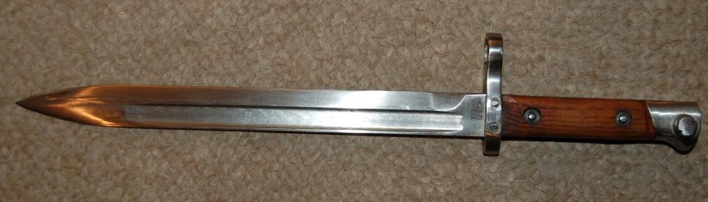

    Bayonet is original but has been refurbished. Imperial eagle is mostly polished off the blade but the manufacturer is still clear. Scabbard has nice Imperial eagle. Blade with these is upward cutting. This is not the original bayonet to this type rifle. Prior to re-chambering they used a bayonet that had another sight attached to the round barrel connection at they shot high when the bayonet was attached. Looking at photos, I believe the front sight may have been replaced during the overhaul as it appears to be taller now than what the sight on the bayonet would have been making it obsolete. Reasons may have been that original sights were set for 300 yards/meters for battle sight and went up from there. Wartime experience showed they needed closer sights.

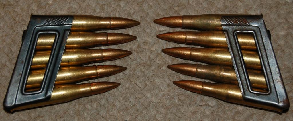

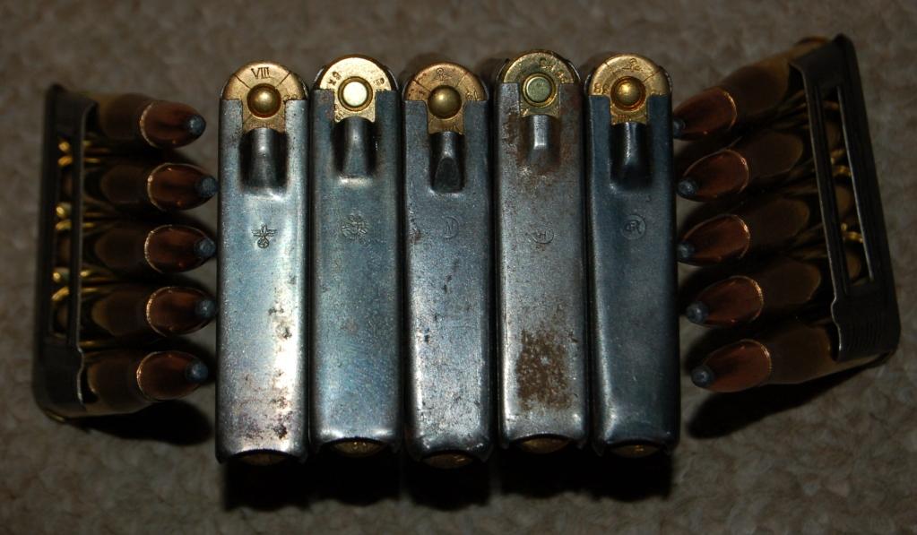

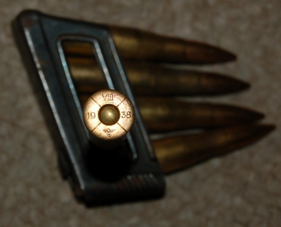

    And last, the clips. Rifle will not work without them except as a very slow single shot. Five different manufacturers shown. Germanicon occupation Nazi eagle, Austro-Hungarianicon Imperial eagle, and three letter stampings. Ammo is Nazi marked 1938 and current manufacture Privi-Partisan.
