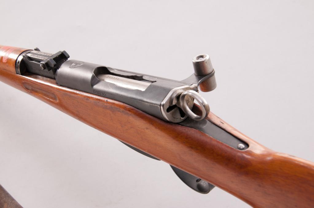

    've developed a serious love for the Swissicon long rifles and K31's that have the Swiss match stickers. Tonight I grabbed a few items at an on-line auction, including two 96/11's and a K31 with match stickers and some kind of front target sight.
    Blueing on the receiver looks matte.
    Description advised:
    Swiss Schmidt-Rubin Karabiner Model 1931 (K31) Straight-Pull Rifle, #848135, 7.5x55mm Swiss, 25.7'' barrel, matte blue finish, European walnut stock, with sling. Import marked, with shooter's name and 1972 shooter stickers. Globe front sight included. Condition is fine to near excellent retaining approx. 95% matte blue on receiver. Stock shows minor dings, scratches, thinning to finish, and light oil staining. Action is crisp, bore is mirror bright.
    Anyone know anything about matte finishes on K31's and what kind of front sight that is?
    I'll post a range report and additional pics when it arrives

    The rifles arrived at my FFL today and I swung by to get the 10 day "cooling off" period started. Gave them a look over and noticed that the bore on this one was very nice. The handguard had some "match sticker" on it, one from 2003.
    I also noticed that the front tunnel sight had a post which seemed to work well in conjunction with the standard rear sight.
    Here is a link to a better pic of the rifle.
    https://www.proxibid.com/AuctionImag.../54734/237.jpg

    I finally got to the range last week and put a few rounds through this one. The front tunnel sight has a post insert that actually worked well with the standard rear sight, except...it is so high that I have to set the rear sight at 800 meters to hit the bull @ 100 yards.
    Here is a pic of the target.
    I fired a couple rounds of GP11 at the above target (a 12" target) at 100 yards...nothing. I finally figured out that it must be low...because the front sight was so high...I set the rear sight at 300 meters and got the two at the bottom of the target backer. Cranked the sights up to 500 meters and got the one halfway up. Cranked the sights up to 800 and finally hit the bull, while aiming at the lower red target dot.
    Obviously going to have to do something about this...probably end up getting the rear diopter.
