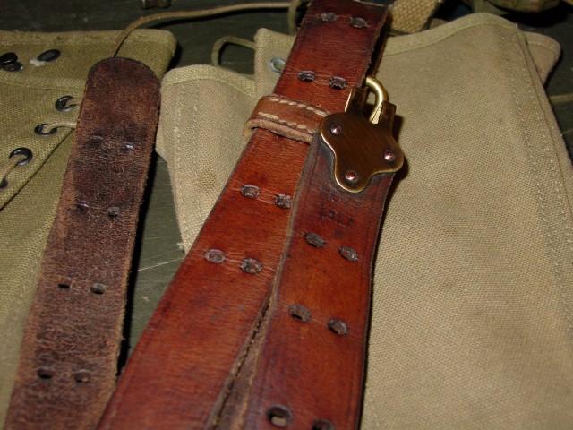

    I found this by chance after trying the products mentioned above without much luck. The new repro slings always looked out of place to me on my old rifles. This sling was lighter colored and stiff - My son always played baseball and I used a product he had that's made to break-in new baseball gloves and it worked very well. It's like a light oil and it penetrated the leather to soften it up as I worked it in, as well as darken it. It darkened the bright white stitching on the keepers too. The hangers were brightly plated with a gold color to simulate brass and looked way too new, so I tried using some inexpensive 'Cold Blue' on them and it worked to blacken them some and make them look older.
    Not perfect, but it's an inexpensive and strong sling that looks closer to a real vintage sling. I have one authentic early sling for display but it's too valuable to take a chance of carrying a rifle with, and it would be a shame to break a vintage sling that old.
    All of these slings are new repros and after handling them I think they looked better than they did in this photo when I first finished them. The baseball glove oil really helped to speed up break-in and soften the leather as it's intended to do for baseball gloves.
