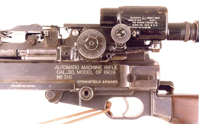

    No, it is NOT for the Benet-Mercie MG. As I already said, take a look into Brophy's book, you'll find exactly the same W&S scope rail pictured. I know it, as I have one of these myself.

    Furthermore, for what I know the Benet-Mercie was flat in the area where the scope had originally been mounted. This picture would suggest the same thing:
    https://www.milsurps.com/images/impo...2/1909_3-1.jpg
