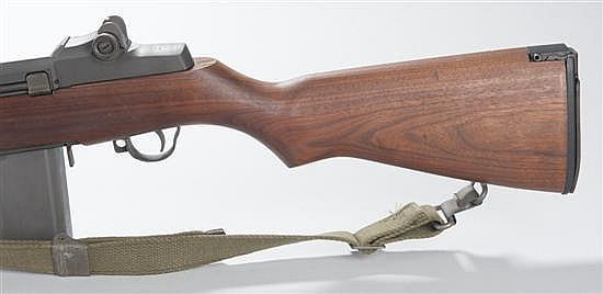

    'm sure that these have been around for a while, but I recently ran across a magazine fed Garand in 7.62 x 51 and wondered if anyone was familiar with them.
    Stock looks like an M-14/M1Aicon. Barrel Stamped "7.62 Nato M11" Over Earlier Stamping And "48353 A191A P"
    Anyone know anything about these?

    Some of the early M11 stamped receivers had been demil receivers that were put together - alot of the magazine conversions depend on the knowledge of the person or persons doing the conversion -quite alot of variation concerning the function and workmanship

    There were a couple of very talented gunsmiths who made them for customers a dozen years ago. I never got around to it, but always wanted one. There were also a number of M1s made to simulate M14s for the movies.

    I really like this and am attracted to having a forged receiver, "M-14-type" weapon, but am leery about getting a demilled or poorly done conversion. It all looks nice, but who can really tell how good the work is.
    ---------- Post added at 02:36 PM ---------- Previous post was at 02:35 PM ----------
    By the way, does the barrel stamping "7.62 Nato M11" over an earliers tamping and "48353 A191A P" mean anything to anyone?

    The barrel markings may be from a 1966 Springfield Armory 7.62 mm conversion ----- or not. We know where the markings are, & we know what they look like; if you post photos, we may be able to tell you more.
    I'd try to get over the attraction. It still has most of the bad features of the M1 rifle: it's too long, too heavy, & it lacks the light recoil of the M14icon-clones.

    I was watching it at an on-line estate auction. It went for $840, which was in my bid zone, had I been able to find out more about it. Just too many unknowns to bid. They had a Poly Tech M14icon/s at the same auction that went for $660...might have been a better deal.

    I liked the looks of this one, even with the the drawbacks that Neal identified, but there were just too many unknowns and no way to get any answers...Rewelded receiver or op-rod...poorly done milling on the receiver...etc.
    Probably just as well that I let it go.
