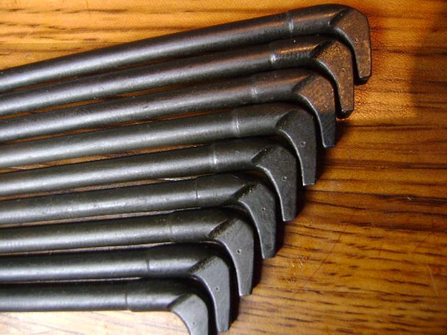

    Are these WRA Firing Pins?????
    Are these WRA firing pins? I was thinking the angle cut looks like SA
    Thanks

    I would have to say Winchester just because of the punch mark. But I'm usually wrong.

    Wish it were that easy, SA parts can also have punch marks

    Billy Pyle's "The Garandicon Stand Report" Spring 2004 No 54 has line drawings of Winchester, Springfield and reproduction round firing pins done by Charles Redfield with acknowledgements to Bill Ricca.
    The top angle on the Winchester firing pins is 55 to 61 degrees while Springfield is 26 degrees. Your firing pins appear to me to be Springfield. Reproduction round firing pins have a difference in the shank slot

    photo from an early 1941 Winchester rifle
    Photo of a round WRA firing pin from a four digit rifleAttachment 39327Attachment 39328
