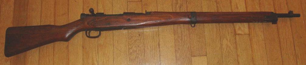

    Nagoya Arsenal Type 99 Rifle (Probably 8th Series but Not Marked) w/Painted Markings
    Having been given a reminder by this thread:
    Type 38 Arisaka Short Rifle with Kanji
    it seemed like a good time to do a photo shoot of this rifle.
    As noted above, it is not series marked but seems to have features of both 7th and 8th series. Given the serial number, it seems probable that it's an 8th series rather than a 7th, as an early-ish 7th would like have several features not found on this example.

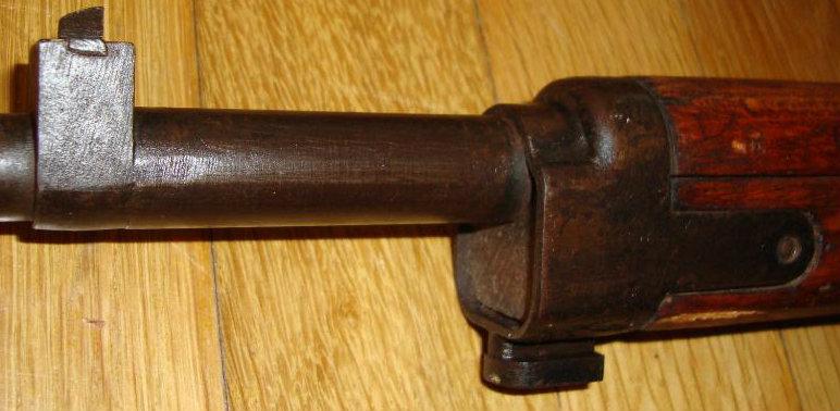

    Additionally, it has these markings painted under the the front band:
    Have been slowly getting the crud off of it, but there is some surface corrosion due to years of neglect. No range time, yet, but the bore looks to be servicable, so it may see action one of these days.
    Last edited by jmoore; 01-23-2013 at 01:13 AM. Reason: Swapped fore end marking photos

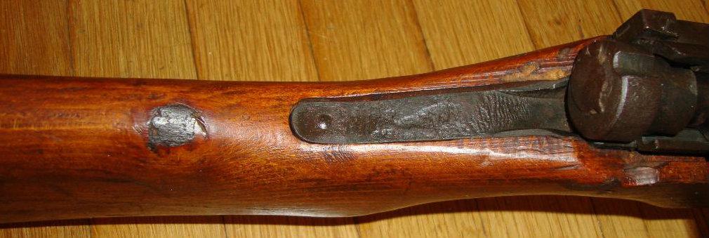

    a few more detail shots:
    Note the browning of the area where the mum was removed. The rifle probably wasn't oiled from soon after WWII until circa 2003! Dust encrusted as well.
    Of note here are the rough upper tang and the big ol' knot on the comb.
    A small inspection stamp is noticable in the front face of the fore end. Did not see it until cropping the photos.

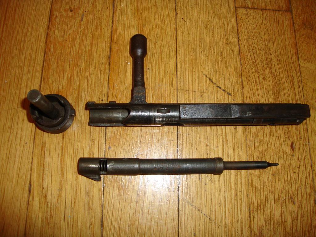

    The bolt assembly numbers match the last three digits of the serial number. But the interesting thing here is the fracture in the firing pin. Looks like a manufacturing defect. Created either during milling of the slot or in heat treat.
    No bolt face wear aside from the follower mark. Probably never made it to the field.
