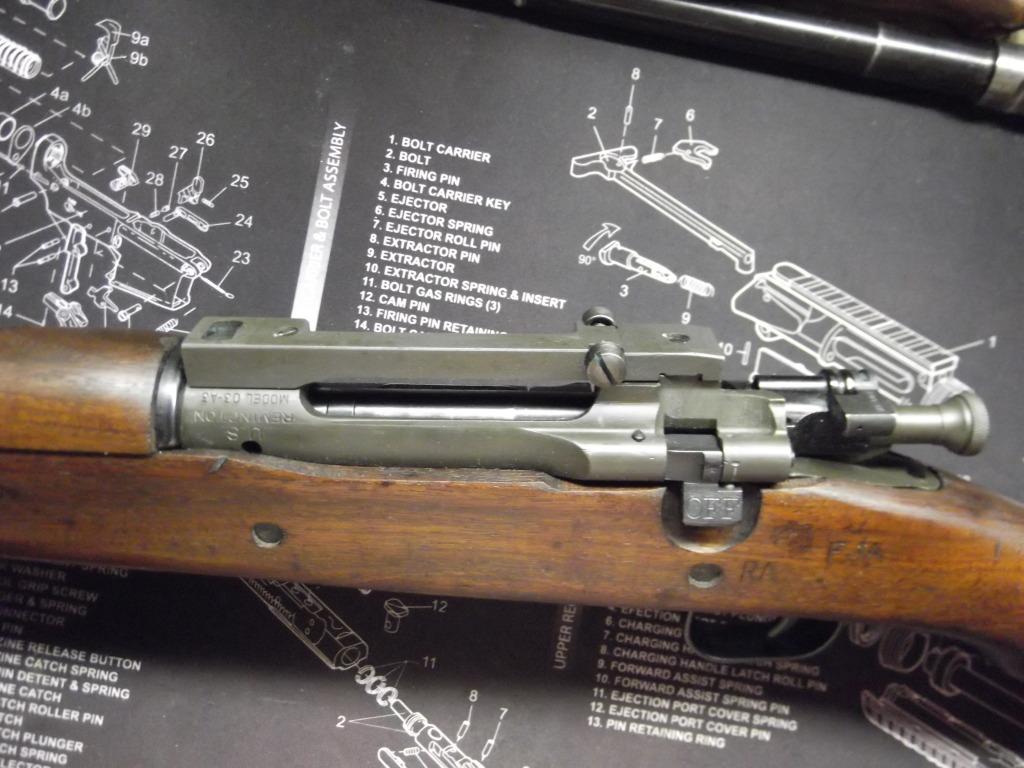

    Here are some pics of the rifle, I'll take some of the scope and rings this evening. I think the rings are the wrong height from the few pics I've seen
