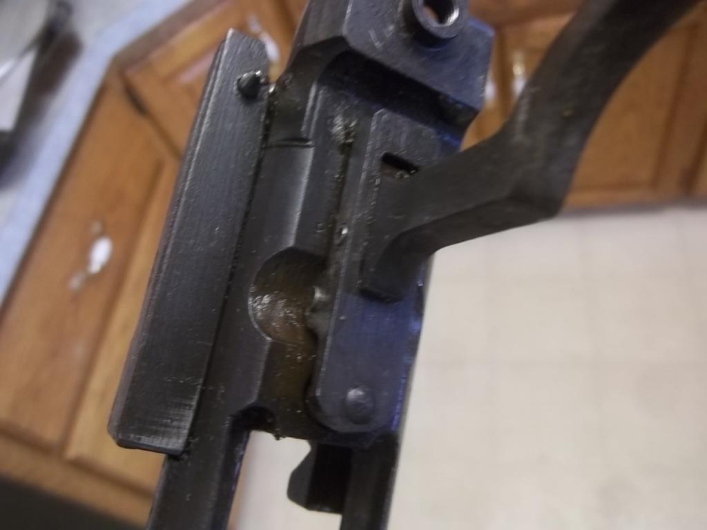

    After much soaking and elbow grease, I have this:
    Now the rear tang looks like it has seen some service. I don't know if the IJA "peened" the metal around the hole to get a better fit, or of this was Yank. ingenuity. Due to the "rough" feel, would this be original, or a swapped out tang? If I swap it for something in better condition, I would hate to over restore this nifty rifle.
    Even the bolt cleaned up well.
    If I didn't replace the monopod, it would certainly save some $$. But as I mentioned, I would like to make it authentic as possible.

    Wow! That cleaned up great!

    Midmich, That did clean up nice. I would't feel bad at all about switching a few small parts out for better ones. I would feel diffently about this if it were all matching and staked but this one has already been altered so you may as well make it look presentable. I wouldn't refinish anything though. Regarding the monopod, it never had one originally so I wouldn't worry about finding one. Salt Flat
