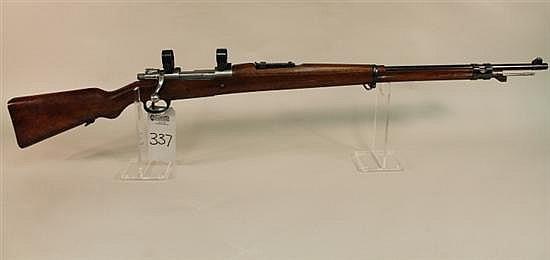

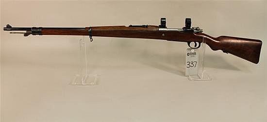

    I know this is going to drive some collectors up the wall, but here goes...
    Last year I glommed a beautiful Persian Mauser that someone had drilled and tapped. I knew it had no collector value, but it was priced accordingly and I was interested in using in the "open" class at a military silhouette match that my sons and I shoot in.
    Understand that I couldn't do this to a unmolested mil surp myself. Since someone else had already done the dirty work, I could not restrain myself. I finally used it in a couple of the matches and the Persian did pretty well.
    Ever since I found this one, I've wanted an Argentineicon Mauser in the same condition. Well, today I glommed the Ayotollah's South American cousin at an on-line gun auction...
    Hoping that this is as good a shooter as the Persian. Better pics when it arrives.

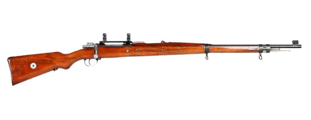

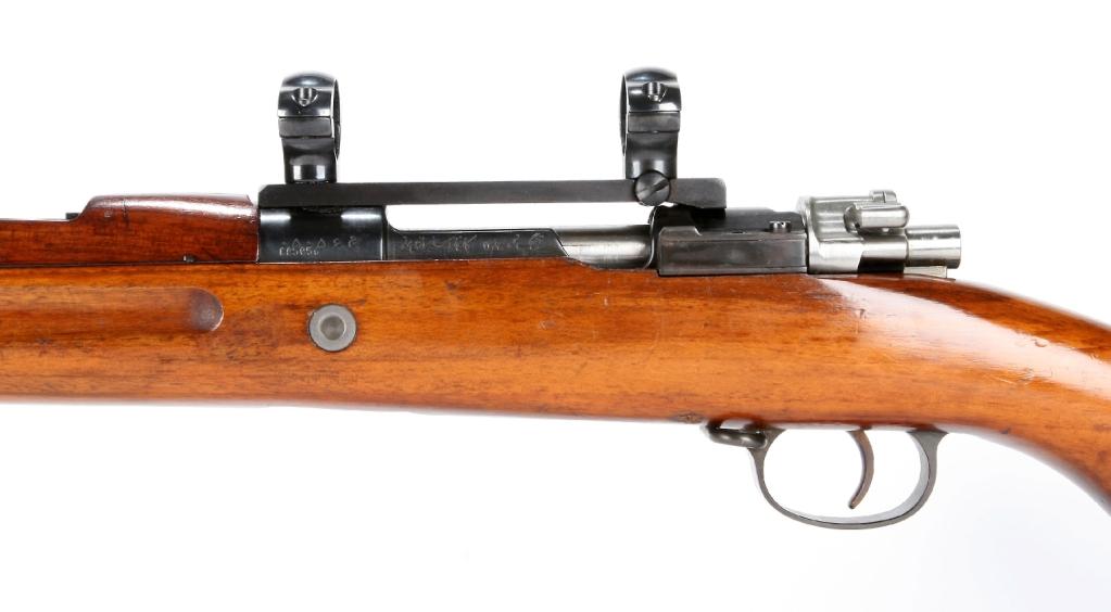

    Huh, must be bubba'd Mauser day or something. I came across this stuffed in the back of the closet with some non shootable parts guns this afternoon. I had forgotten I even owned it or why it would be mixed in with parts donors as it's a very good shooter. Last account I have of shooting it was at a deer(killed it deadern a hammer) in September 2008. Not really sure what it is...uh was. Never had the bases off to look at the crest but I'm leaning toward 1924 Yugoicon. I think.

    That is a very nice looking Mauser. I would bet your are right about that being a 24 Yugoicon. Looks like a very nice turn down on the bolt handle.
    Is the action an intermediate length or full K98icon length?

    Thanks. Yours are quite nice looking as well. It's intermediate. I bought it for the reciever with the intentions of rebarreling it to .250 Savage but after shooting it decided to leave it as is. Paid a whopping $90 for it just as you see it, minus the sling. Thats off my SSA M40, perhaps I should remove that and put it back in the box. If I ever sell it some clown will make a big issue out of it missing the sling that came with it.

    One step ahead of ya Salt. Scope is a Lyman challenger but it and the mounts went cheap on ebay a coulpe years ago. Appearantly someone else had the same idea but found out it's not as simple as it looks, especially with the LSR mount. The barreled action is a 43 Spanish thats been d/t already so no concerns about destroying a valuable collectors item there.
    Now I just need being in the mood to coincide with the time to do it.

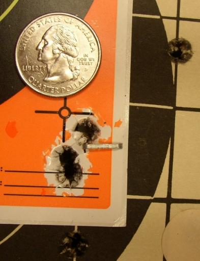

    I'm using 45.0 grains of IMR 4064 with a 200 grain Nosler Custom Competition bullet. It shoots pretty well, but I still get an occasional flier.
    Except for the pesky flier, 45.5 grains of 4064 didn't do badly either

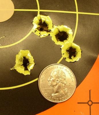

    I've got several of the unmolested 1909's, including this one...
    It shoots quite well, once I got the overall length right.
    40 grains of 4064/174 gr .311 SMK/CCI 200 primer/2.875 OAL @ 100 yards off a sandbag rest
    IMR 4064 has become my defacto favorite powder. I experimented with 40 to 43.5 grains of 4064 with a .311 SMK seated to 2.875 OAL. Took me 4 rounds to get the seating depth correct (first 4 were seated too deeply). Those 4 went high and a little wild. The next 6, all seated to 2.875 OAL, grouped together.
    I'm figuring that the bullets seated too deeply may have reduced the case volume and caused a minor pressure spike.

    You should have no trouble winning matches with groups like that. My rifle favors IMR 4350 with Sierra 175 and 220 grainers and with Nosler 180gr Ballistic tips it's at it's best with IMR 4064. Just for plinking it does reasonably good with 154gr Turk surplus. The best accuracy is with the Sierra 220 gr and IMR4350, consistant 5 shot groups less than 1 MOA at 100 yds. The Noslers are a little over 1 MOA same distance but I have'nt done a whole lot of testing with this load. Hope to remedy that shortly. Unfortunately theres no competitive shooting events within sane driving distance that I know of so I'm stuck with deer, hogs and the occasional watermelon for targets. Whoever it was that molested mine took a fair bit of time with it, barrel channel opened up, action shimmed so the barrel only makes contact with slight up pressure at the stock tip, bayonet lug and upper band have been ground so theres no contact with barrel. Handgard only touches at the clip behind rear sight. The only quirk it has is with a cold clean bore it requires a fouling round otherwise it tosses the first shot off to the left about 3'' @ 100 yds. BTW, thats a mighty fine looking 1909, they sure have went up in value in the last 15-20 years. Last one I had cost 69.99 at Roses around 1995, wish I still had it.
