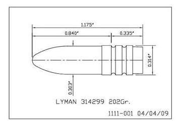

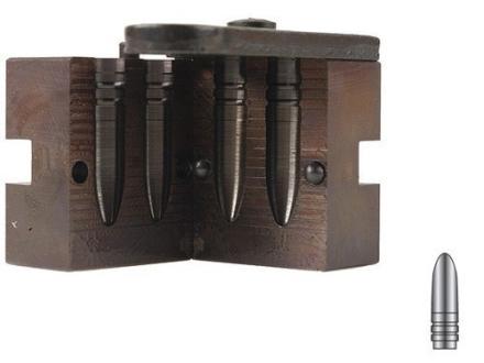

    Midway: Lyman 2-Cavity Bullet Mold #314299 303 Caliber (314 Diameter) 200 Grain Round Nose Gas Check Product #: 530266 Lyman #: 2660299 UPC #: 00011516202994
    $68.99
    Status: Out of Stock, Backorder OK
    Date expected in stock: 05/15/2013
    Graf: LYMAN 303cal 200g #314299 (.314d) MOULD DBL CAVITY
    Item #:LY2660299
    Price:$67.99
    Availability: Out of stock Login to be notified when it's back in stock
    Vendor:Lyman Reloading / Black Powder Equipment
    Product Information
    Lyman molds are made from solid steel and heat-cured to oxidize the metal. This blues the mould and minimizes the time required for the breaking-in process. A steel sprue cutter is included. Accepts Lyman double-cavity mold handles, sold separately.
    eBay: Lyman 2 Cavity Mould 303 British 314 Diam 200 GR 2660299 Gas Check | eBay

    Mid South shows that mould to be in stock. $58.05
    International shipping available too.
    Reloading and Shooting Supplies, Tools and Equipment | Midsouth Shooters Supply

    The 314299 is also good for the 7.62x54R. You really want it sized 1-2 thousndths over bore size for best accuracy so slug you barrel before getting a sizing die.

    I believe you'll find it more satisfactory to size a bit over groove diameter. Sizing near bore diameter doesn't leave much for the rifling to engage.
