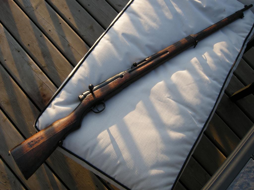

    Hi guys, just expanding my collection and I purchased a Type 38. I don't know much about it and would like some help to find out more about it. I think it is a Tokyo arsenal, unsure about the series. The mum is stamped over with three circles, possible from Thailand use?
    It is not a numbers matching rifle.
    Thanks

    It seems to me to be an early No Series Type 38 made at Koishikawa in Tokyo. It has no front sight ears, and there doesn't seem to be a Series mark to the left of the serial number?
    The branding on the stock and the strange cancellation of the mum make me think it was a school training rifle.

    Looks to be a school rifle.
    The first set of characters on the left could read GAKKOO or school, the second set on the right could read TATSUMU or doing your duty. Just making a deductive guess since the characters are obscured.

    Thanks, so being a school rifle means that it was removed from military service and used for training purposes? The rifling looks worn but from what I've found for info would be normal. Is there anything that a person should check for before shooting one?

    Yep, removed from military use, and given to a school for cadet training. One thing to bear in mind that is often overlooked by people just getting into collecting Japaneseicon rifles is that they all have Metford rifling, which can appear to highly worn out.
    Arisakas have one of the strongest actions out there, give it a good clean up and shoot it.

    This is what I think I see. I could be wrong. The other hard to see characters above it could change the meaning again.

    I am NOT a Gunsmith or Lawyer... and don't play one on TV. If you are concerned about anything, have a gunsmith check headspace.
