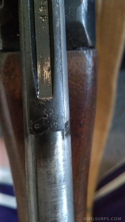

Thank god for youtube, I was able to get to the markings on the barrel. Thanks for all the help and support. As always more info on this would be great!

Very nice indeed! The bolt is a later replacement by the look of it. The wood is indeed original, low cut on the right hand side, as it was originally intended that these would have a magazine cutoff such as was found on the Long Lees and early SMLE's. The cutoffs were dumped from the SMLE Mk III design during WWI, then resurfaced again in the 1930's on the Mk V and early Mk VI/No 4 but were rapidly dumped again in early WWII. These early Long Branches had the wood designed to take them, but that "low cut" was eliminated early on in production. Am I reading the numbers correctly, that the stock serial number is 0L1813 but the barrel is 0L1823--10 digits off What is the serial on the receiver--1823 or 1813? BTW, that is a 1941 dated barrel so original to the gun. You have a nice early production Mk I with original early wood, matching or close to the rifle, with original barrel. Enjoy!
Ed

Actually, one other question out of pure personal interest. On the barrel, somewhere around the '41 date, there should be an inspector mark. Is it by any chance a 56 in a circle?
Thx
Ed
Legacy Member
The stock, barrel, and wood are all marked OL1823. The latter I am not sure. I will check. [Update] the only number I can see is a 82 (or a B2 cannot be sure) above the 41
